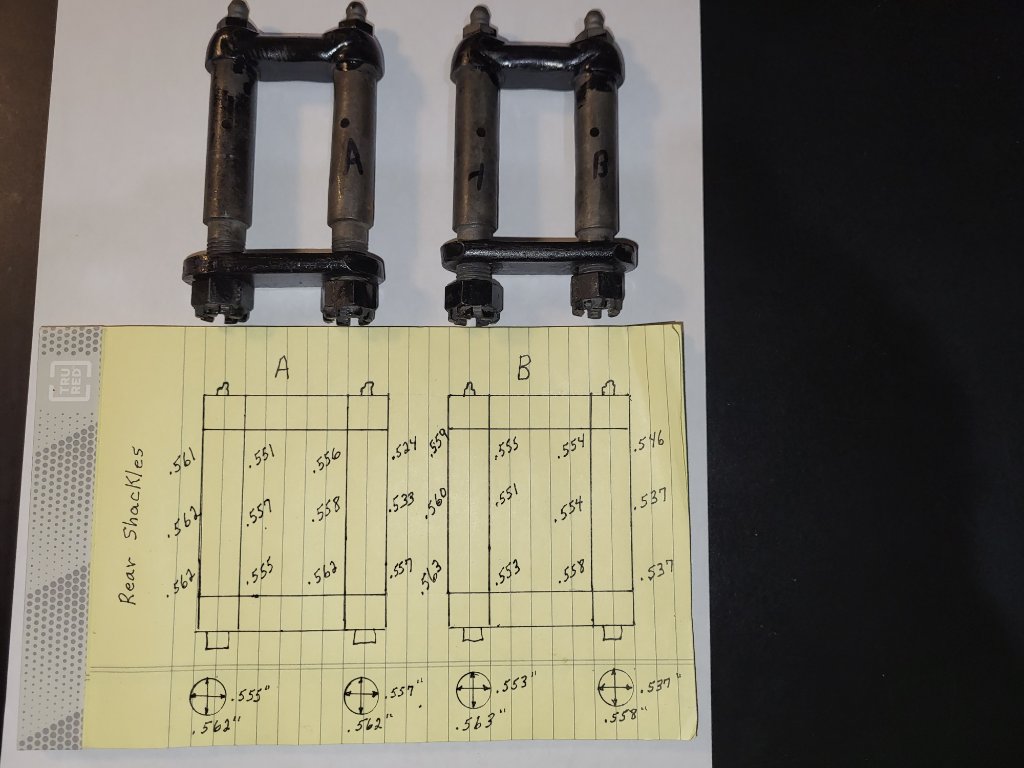

Bruce can you send pictures of the spring and shackle bushings and shafts? Also, using a precision caliper (see attachment), provide measurements of the ID of the bushings and OD of the shafts. With that, perhaps members with more knowledge can determine whether or not they need to be changed. We need to know if the bushings and shafts are oblong. If oblong, provide measurements of the longest ID and OD. If shafts and bushings are perfectly round, they are probably not worn, for when they wear, they wear in the same place and become oblong. Jim Patrick

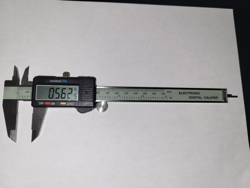

Jim, Here are photos and measurements you asked for. The ID of the bushings is 0.562".
Are these reusable ?
- Posts: 5579
Re: Spring Shackles
Just a FYI - those appear to be Model A - Model T's didn't use grease.

I would not automatically assume that an axle rebuilder replaced the perch bushings. That really should be verified, and for the effort you are putting into this car, while reusing old parts may be "OK", new parts with correct geometry will give better service. As the parts wear oblong, the bearing area decreases and pressure increases...oil will have less ability to stay put and do its job.
This advice is generic as I have done very little work on later cars and as such, think you should research Steve's advice on those perhaps being "A" shackles. I do not know, but Steve is a sharp guy.

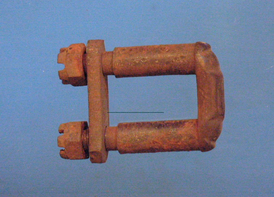

- Posts: 7411
Re: Spring Shackles
1923-1927 Ford shackle.

I have verified that new bushings were installed in the rear wheel perch. Based on my caliper measurements of my shackles and amount of movement I get when they are inserted in perch and spring, I have decided to purchase new shackles.
Looking at Lang's and Snyder's catalogs, I have two choices: The forged shackles (like shown in Steve's photo) at about $160 per set or the U shaped $30 per set ones, which have the bolts pressed into the cap piece.
