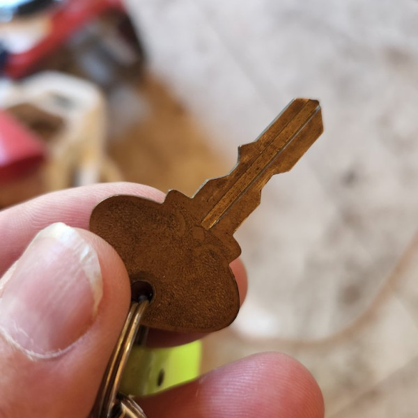

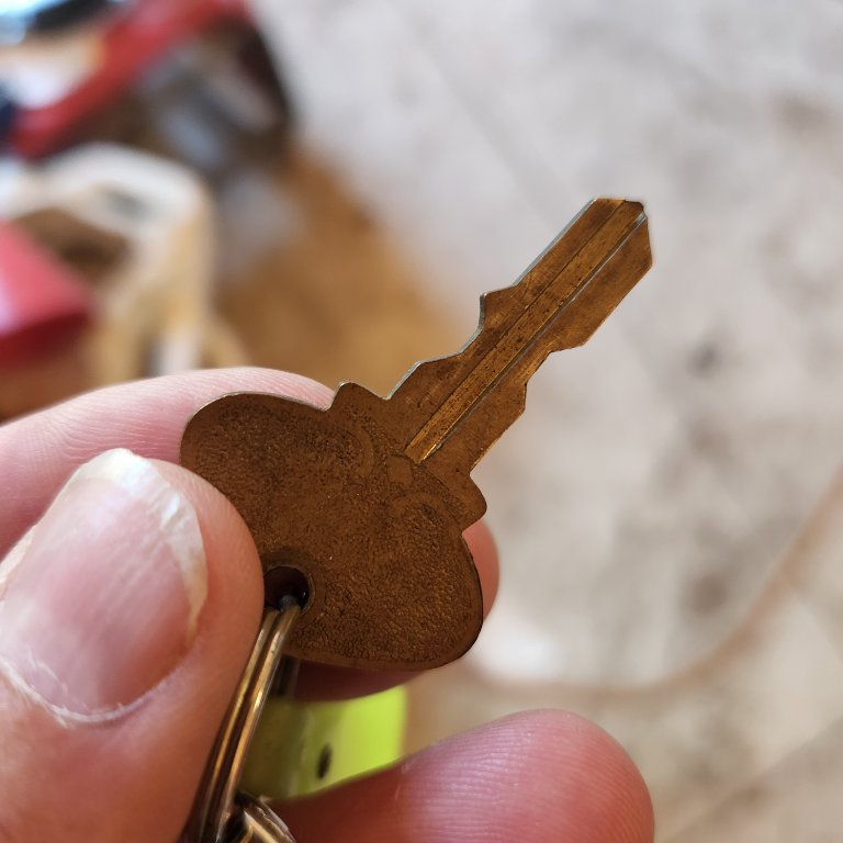

Trying to help out a new guy.
Probably any key may work, especially a 55, however he wants a matching key
No numbers on this key.
Anyone tell what number this maybe!

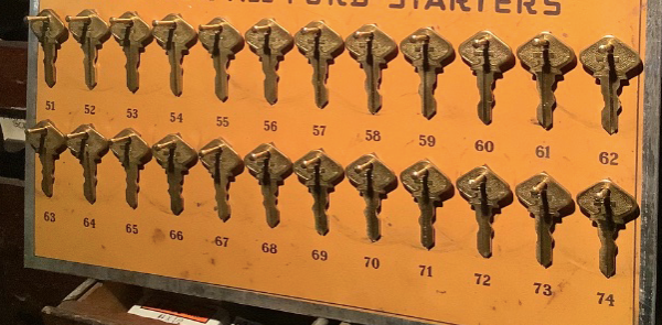

Really hard to tell without the other keys to compare. (my keyboard is at the winter house)
Ford only had 4 tumbler notch (teeth) combos, the rest was done with the groove locations on the blade.
Here is a picture of a keyboard with a set of keys...maybe you can zoom up and see????

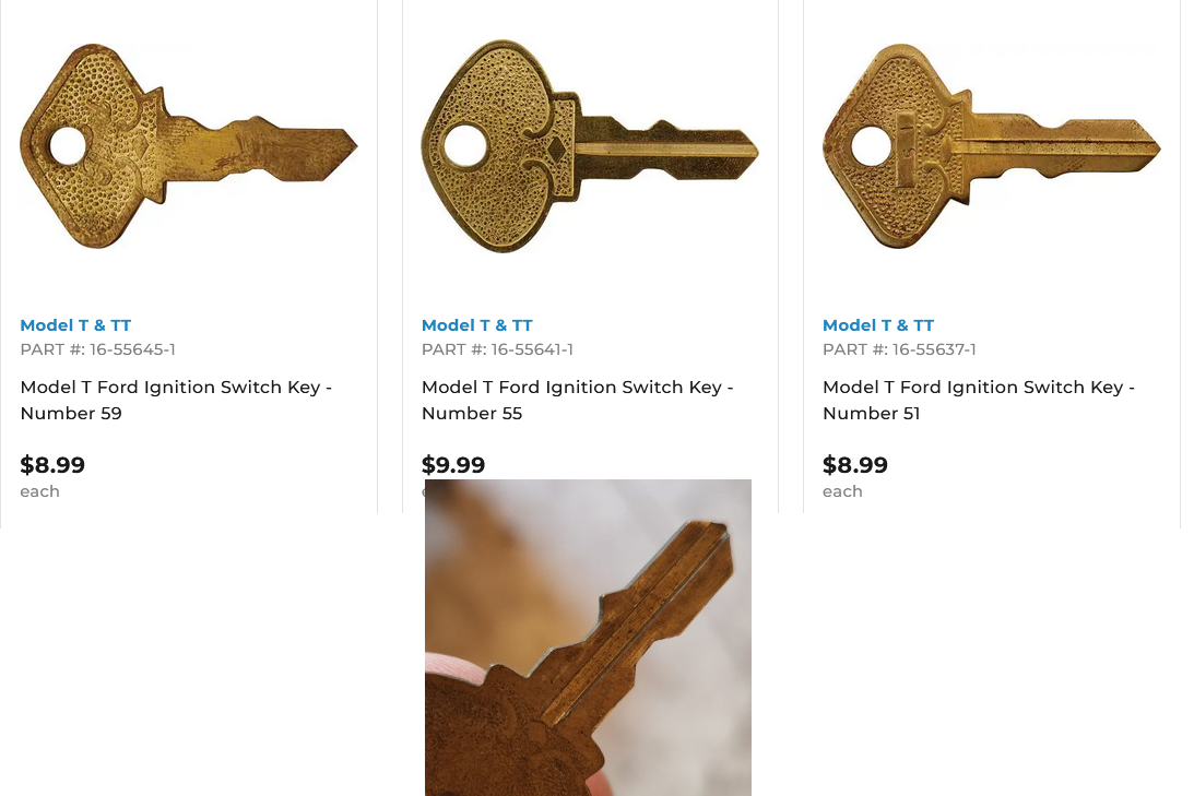

Looks like MAc's/Ecklers took the time to photo ever key individually. #55 guesses appear to be correct
https://www.macsautoparts.com/catalogse ... %20t%20key

Sure looks like 55 as many said.
I'll get a 55 and try!.
