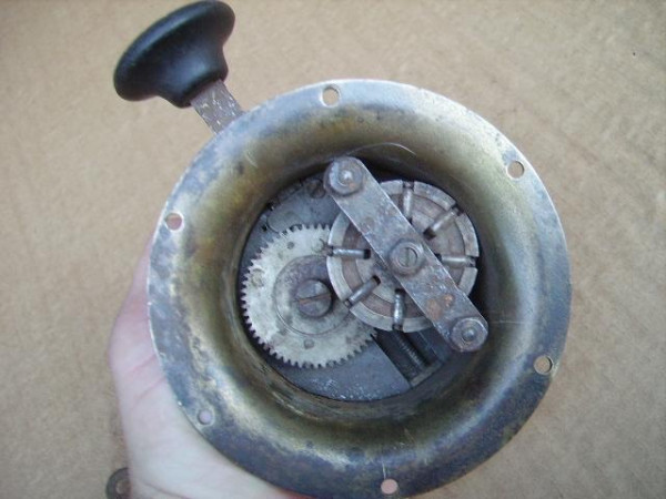

That horn should be very easy to repair. Just take it apart and go from there. WhT can it hurt? The activating mechanism consists of a plunger connected to a straight piece with teeth that engages the teeth of a disc fitted with teeth that turns against an opposing serrated piece fastened to the center of a metal diaphragm that when rapidly turning produces the ahoogah sound. A spring fastened to the straight piece with the gears causes it to pop back up when released. It may be something as simple as being dirty or rusted and in need of a good cleaning and lubrication. Several things that might make it more difficult to repair is if several of the teeth are broken or worn off or if the return spring is broken, but it should be fun to take a look and give it a try. Jim Patrick

Took it apart and the 2 waffle shaped pieces are missing. Does anyone know where I can get parts for this horn?

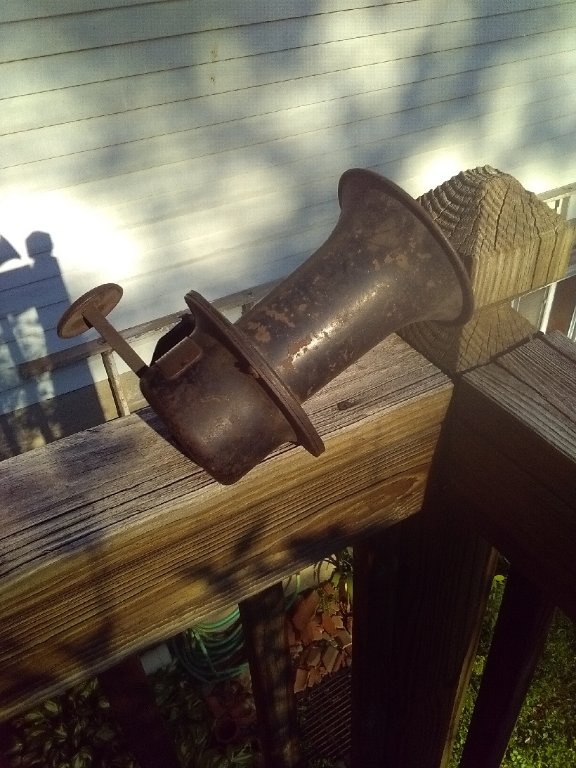

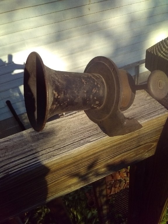

Post by andy2794 » Sat Sep 03, 2022 6:18 pm
Here are some pictures, I can get more. If you need more let me know what pictures you want.
