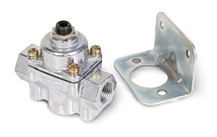

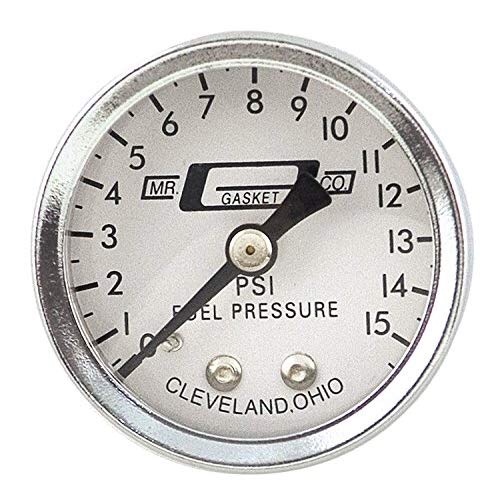

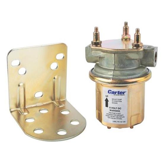

AdminJeff
Re: Fuel pump
My car came with a Winfield carb and a fuel pump. I tried running without the fuel pump, but no go. Especially on my 1/2 mile 20% + grade hill all the way up to my house. I’d rather make it up the hill under my own power than have my wife tow the T up the hill with my Ford Explorer. Again...although she’s getting pretty good at it at this point... “this is the last time, I swear.”
After much trial and error I finally came up with a reliable setup with an on/off switch under the dash. The Napa auto parts 6v fuel pumps and especially the low pressure regulators are total garbage as the one that came with the car failed and the exact same pump purchased new leaked. And you won’t find a low pressure 6v fuel pump. I tried.
Here’s what I now have, it’s rock solid, all purchased on eBay since Amazon won’t ship these restricted items to my retarded state of CA
Carter P4259 6-Volt Electric Fuel Pump $52 .
Holley 12-804 Carbureted Fuel Pressure Regulator 1-4 psi. $37 .
And just for ease of adjustment, a simple pressure gauge $15 (unnecessary but useful)
Mr. Gasket 1561 Fuel Pressure Gauge Add a few brass fittings to string them together, all found at your local hardware store. All mounted right next to the fuel tank on the frame rail. Adjust for 1-1.5 psi and you’re golden. This is probably the ONLY system on the car I haven’t touched in the past two weeks. It just works.
Jeff
