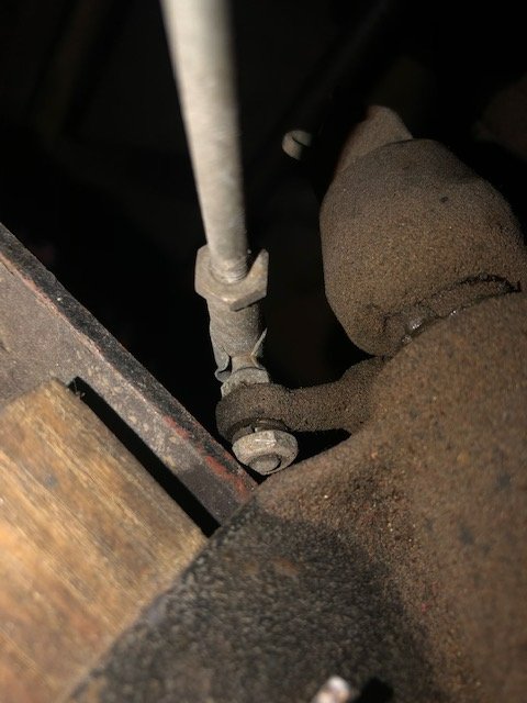

Hello,
I am looking for a swivel like this.
Any idea where I can find one?

Post by perry kete » Fri Sep 16, 2022 11:50 am
Looks like the ball joint from a riding lawnmower steering linkage

Post by speedytinc » Fri Sep 16, 2022 12:02 pm
Its carb linkage. Try napa.

Post by tdump » Fri Sep 16, 2022 12:16 pm
Check the carb linkage that fits a K241 or similar model Kohler engine used on cub cadet garden tractors.

Re: Looking for this swivel
Post by Craig Leach » Fri Sep 16, 2022 1:46 pm
Hi Steve,
Try 1950s- 1960s ford throttle linkage I'm pretty sure there are some of those on my neighbors 57 T bird.

Post by Dan McEachern » Fri Sep 16, 2022 2:35 pm
McMaster- Carr has a good selection of swivels depending in the rod size you need.

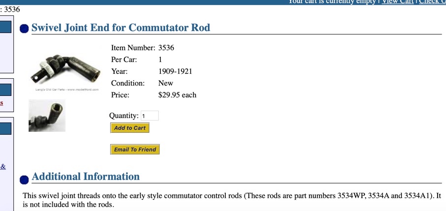

Post by DanTreace » Sun Sep 18, 2022 9:51 am
Lang's sells that part for the early timer rod end. Have a spare one, new in pkg. too.

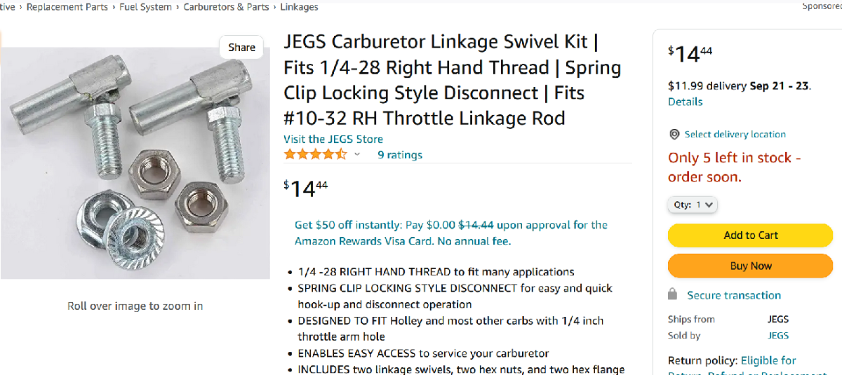

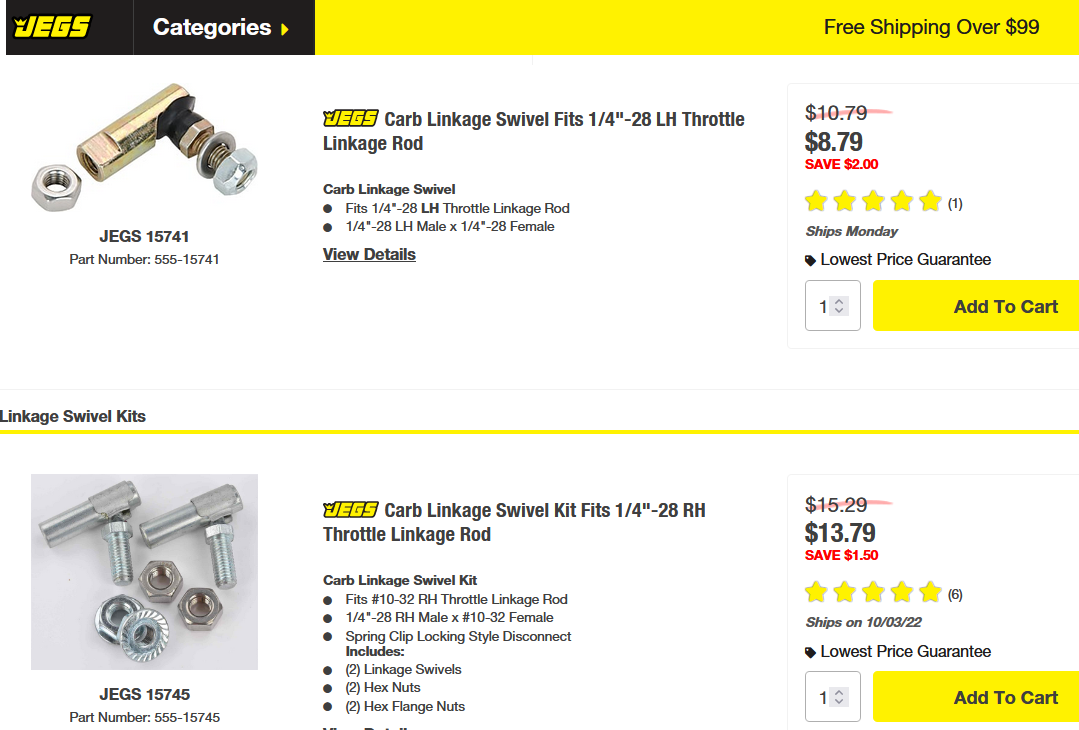

Post by TRDxB2 » Sun Sep 18, 2022 12:22 pm
Following the link that Craig Leach provided above.
Jegs has many similar styles - click the link and scroll down
https://www.jegs.com/p/JEGS/JEGS-Carbur ... 3/10002/-1
There are more than these two
Jegs part on Amazon

Post by TWrenn » Mon Sep 19, 2022 9:33 am
This is his best bet!
Thanks for posting Dan! I was looking for them too, but sheesh couldn't find it!
