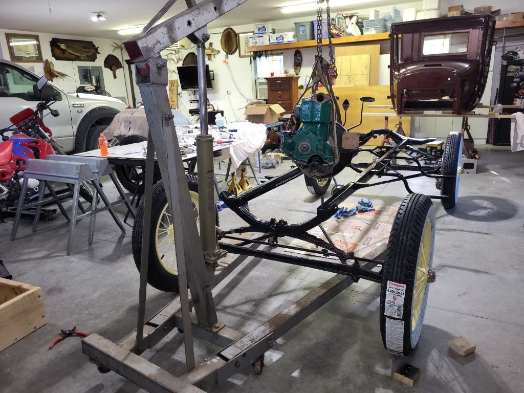

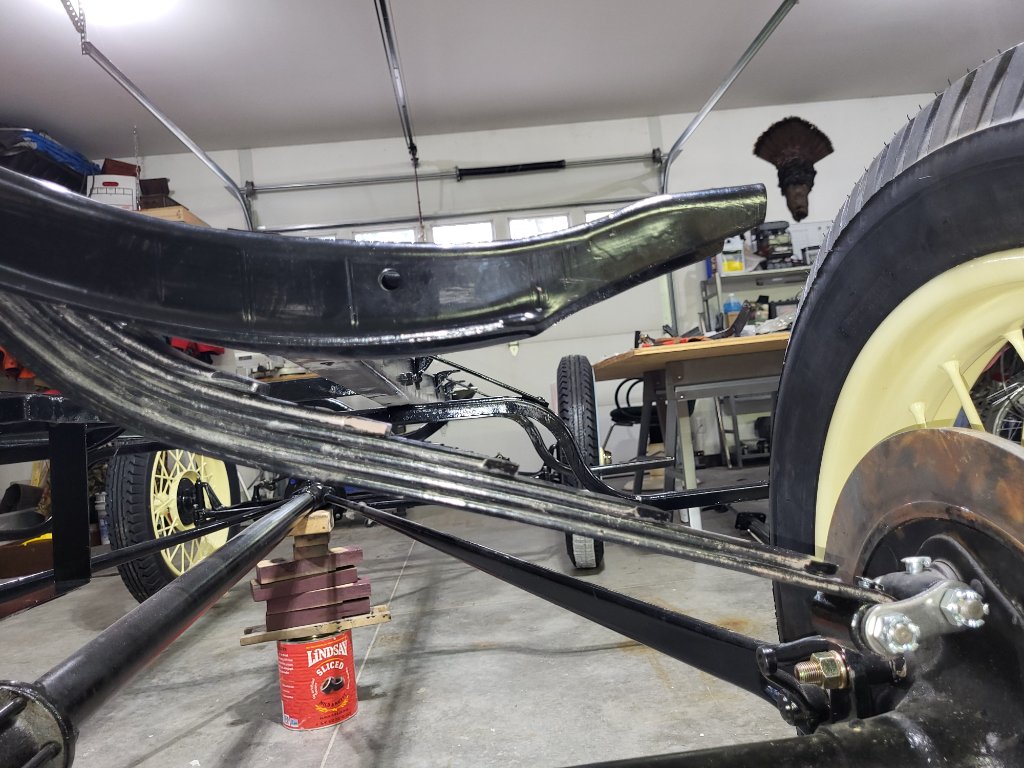

I have a couple of questions before I install engine onto the frame.
I painted the front engine mount. Should I lubricate it before installing the engine?
I have not painted the ball at the end of the wishbone. Should I lubricate it?
How did the factory tighten the shackle bolts and the front and rear engine mount bolts?

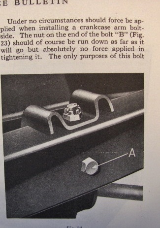

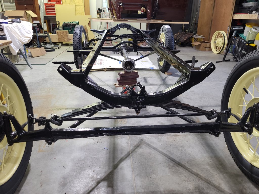

I'd put some grease on the front engine mount and on the wishbone ball. The pan snout is supposed to be able to move in the front motor mount, like a connecting rod on the crank pin. If you use the stock type rear motor mounts that have wood blocks between the pan arms and the frame, do not tighten the bolts that goe through the wood blocks. It needs to be snug, just a little more than finger tight. The bolt that holds to pan arm to the top of the frame rail needs to be tight.

Good thing you asked - Pat explained it well. People often forget that the frame flexes and the engine mounts need to be able to move a little.
When it comes to the wishbone ball I use a really clingy grease as there is no way to grease the ball without partial disassembly. Also remember that the nuts securing the cap on the wishbone ball must be secured using safety wire as the studs can turn out otherwise.

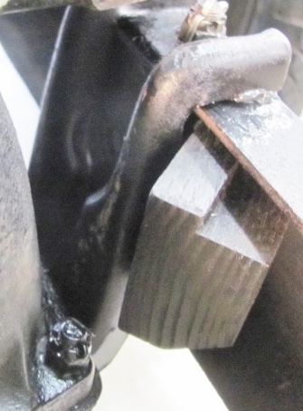

Here are some photos on how the mounting blocks slip in. There is a short bolt that goes through the top of the ear and the nut secures the short bolt just under the top chassis ear. There is a long bolt the goes all the way through the wall of the chassis, through the wood block and through the ear where the nut secures the long bolt. The angle of the block goes against the inside corner formed by the bottom chassis ear and chassis wall. This angle opening was cut there for the fuel line to pass through on its way to the carb, on cars with the underseat gas tank. Jim Patrick

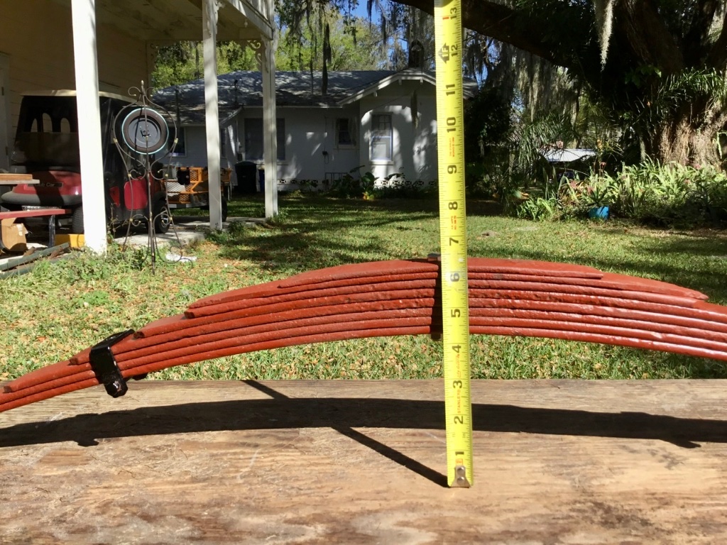

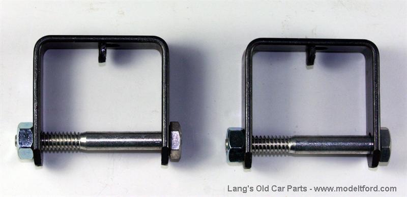

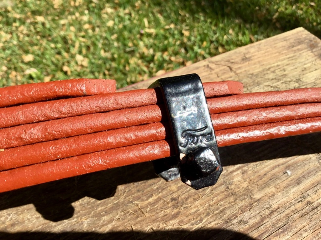

Are you going to put spring clamps on each spring to keep the leafs lined up? Those protrusions in the top of the clamps go into the holes on top of one of the leafs. Jim Patrick

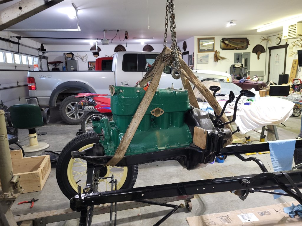

Jim, My grandson pointed out me that I had not installed the spring clips. They are now in place. The engine is now in stalled by son and grandson!

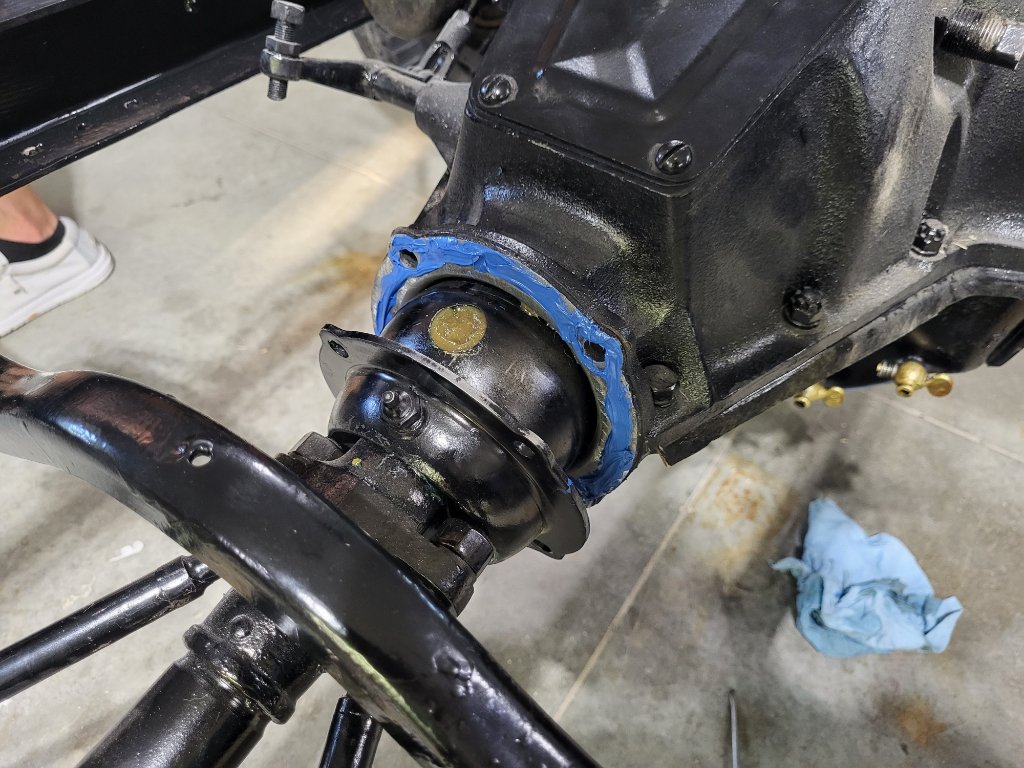

Bruce, Just a note on your next to last engine installation picture. The engine side of the ball cap at the transmission gets a gasket but the drive shaft tube ball side of the ball cap gets no gasket. If you leave that gasket on the drive shaft tube ball side you may find that the drive shaft cap fit will be a little loose and make a raddling noise in use.

The spring clips are important. You don't want to omit them. Another thing to check is to see whether the corners of the pan arms are touching the edge of the upper frame flange when the engine is installed. There needs to be some clearance at that point, or the pan arms are apt to wear notches in the edge of the frame flange, which can lead to the frame cracking. If there is less than about 1/32" of clearance, I'd put a flat washer or two between the top of the pan arm and the frame. (See pic 4 above; look just above the wood block.)

If that blue RTV gasket compound on the fourth main ball joint has set up in that rough condition, it will prevent a good seal. You will need to scrape it off and re-apply it. I use the gaskets along with the RTV gasket compound and do half at a time. In this case, I would apply the RTV to the rear of the engine, line up the gasket with the four bolts and bolt the ball portion half in place. I then tighten the bolts and let it setup overnight. Installing all gaskets in this fashion, one half at a time will keep half the gasket securely in place, allowing you plenty of time to align the two halves. Once aligned, RTV can be applied to the other half and the other half of the piece secured and tightened. Jim Patrick

no real harm, I suppose, but no gasket or sealant goes there anyway...it will only serve to keep the ball coupling off of the ball and lead to looseness/rattles. The only seal is the OTHER side of the 4th main, and the engine builder has sealed that when the alignment was set.

Engine rebuilder installed a gasket on the engine side of the fourth main. I placed the RTV on the other side and immediately tighten up the four bolts.
Re: A Couple of Questions
Post by Norman Kling » Wed Sep 21, 2022 9:41 pm
As long as you tighten it up before the sealer has set, it will be ok. There is no seal in the ball joint around the drive shaft, so you might get some drips there. Actually it might be a good thing if you drip some in that area, because if it is too tightly sealed, any oil which makes it beyond the 4th main and the grease in the U joint will go all the way to the differential and dilute the grease there.

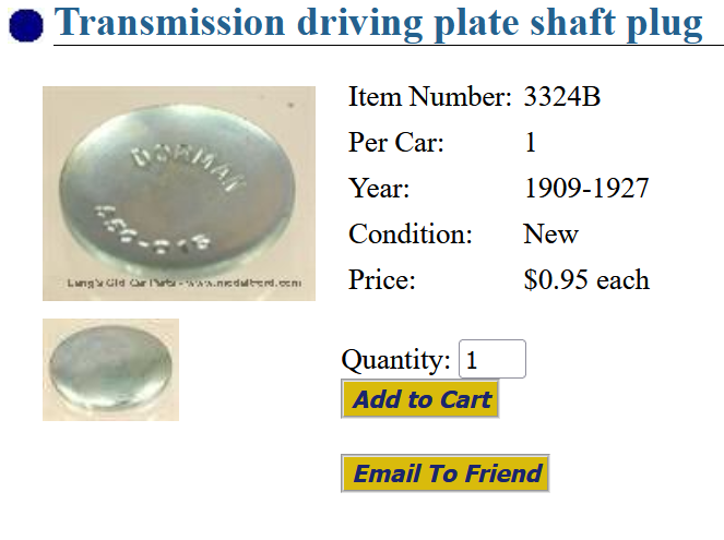

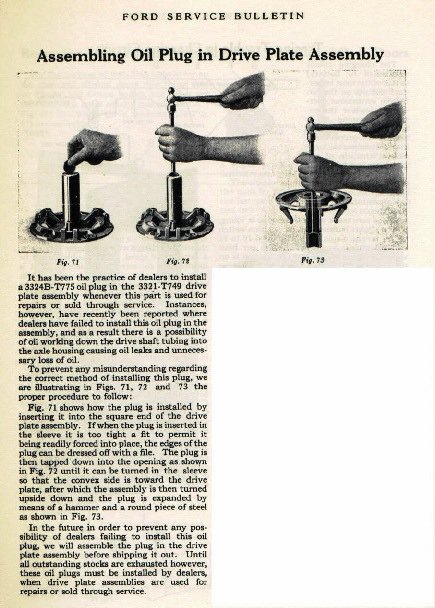

Do you know if you have one of these? Just shine a light into the shaft.

Frank, I can't look into the shaft. The ball joint is bolted up. I would assume engine rebuilders install the plug as part of the rebuild.
