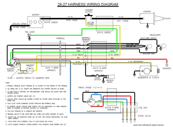

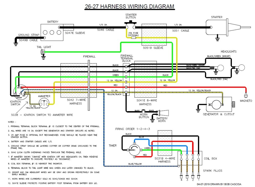

Here is a wiring diagram for reference to the terms used to identify the wiring
