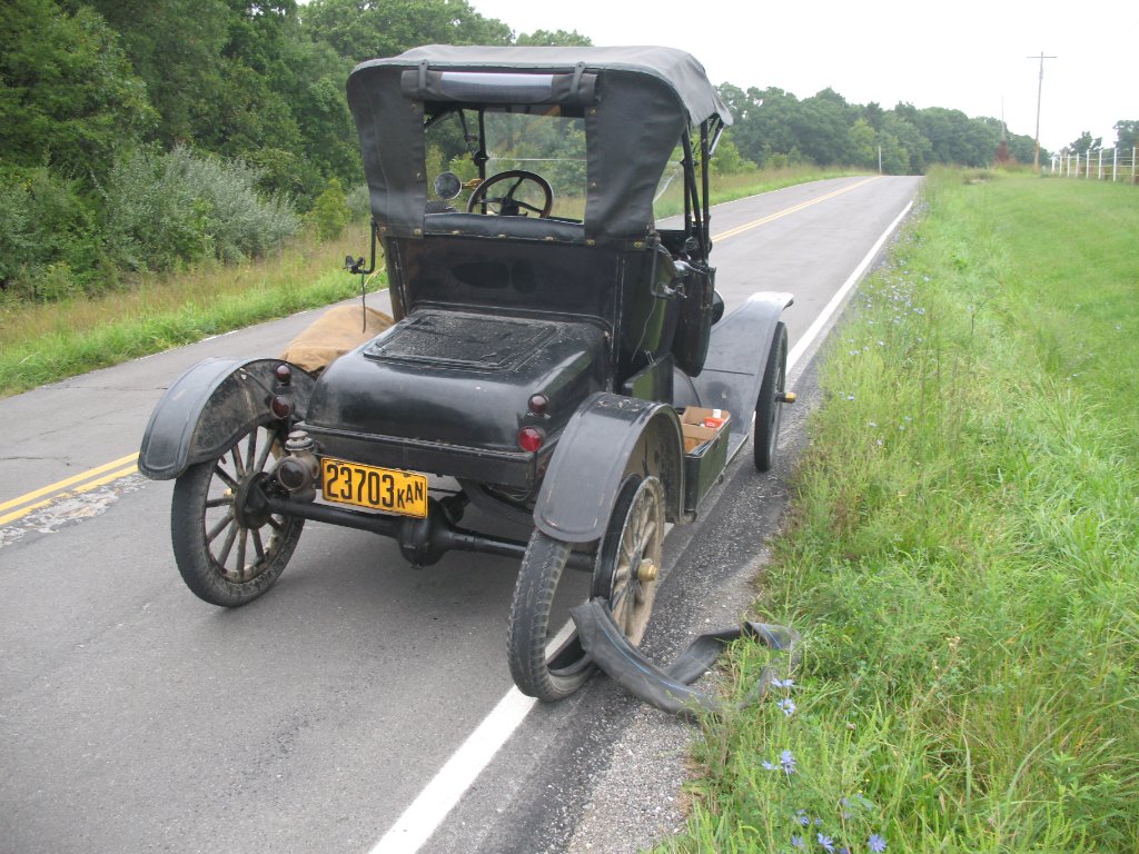

September 2, 2018: Setting out for Michigan, about 40 miles from home, on new Wards Riversides installed a couple of weeks earlier.
September 5, 2022: The tires have worn through the tread to the cords, and this one has died in a blowout.
How many miles from new to defunct? I have never had a speedometer that survived an OCF trip, so most of the following is an estimate figured from Google maps and from adding up miles in a road atlas.
2018 OCF trip: ... 2800 miles
between trips: ... 1000 miles
2019 OCF trip: ... 1800 miles
between trips: ... 1200 miles
2021 OCF trip: ... 1800 miles
2022 until blowout: 475 miles
Total tire life: ... 10,075 miles
I think my guess on between-trip miles (3200) is probably too high.
I think 2000 may be more realistic.
That would put total miles around 9000.
One of my fall or winter projects this year will be new Blockleys all around. It will be interesting to see how they do.

That may be close to right. Motorcyle rear tires wear quite rapidly. Narrow, bias ply tires would probably wear very rapidly on a small front-drive car with no rear brakes.

'Total tire life: ... 9075 miles'. Added up miles = 10,075, did you trail the car for 1,000 miles during part of those trips? 10K seems reasonable tire life for those clinchers, doesn't it? jb
Posts: 7413
Re: Evidence of tire life
Post by Steve Jelf » Tue Sep 27, 2022 2:09 pm
...did you trail the car for 1,000 miles...
No, I stayed inside it and drove. :D
Addition corrected.

Check your rear axle. Make sure it’s square with the frame. That’s what those radius rod threads are for. As to toe: one way to properly set It is to roll the car back and forth after changing the setting. Personally I much prefer four small metal plates. Grease two on one side and put the others on the greased sides. Put them under the front wheels. This allows them to move easily. Works great and allows for a VERY exact setting. New tires are worth the work.
