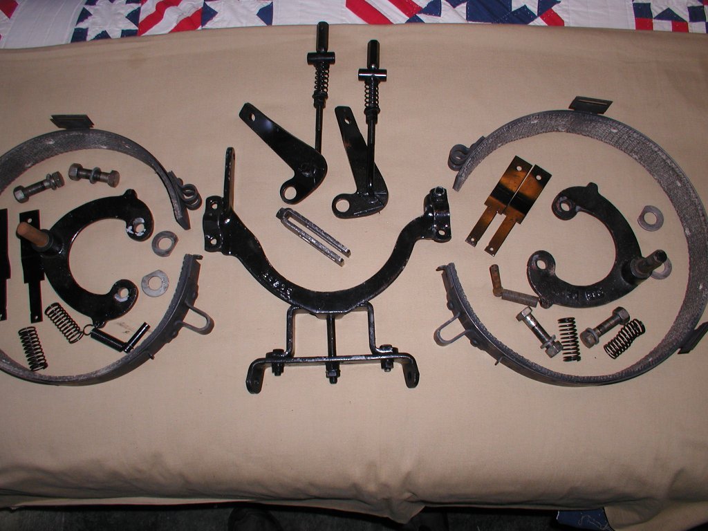

Unfortunately, the phone number and the address don't do much for me. I don't speak English and can only communicate in writing along with online translator. Hence the partly bad spelling in my posts.
Unbelievable. Communicating with you in English like this would have been impossible for me some time ago.
So the only way for me is email.
What I see in the pictures, the model A clevises could be sold as a set. Would these be strong enough to drill out the holes to 3/8" to fit the Rocky's?
greetings from Switzerland
