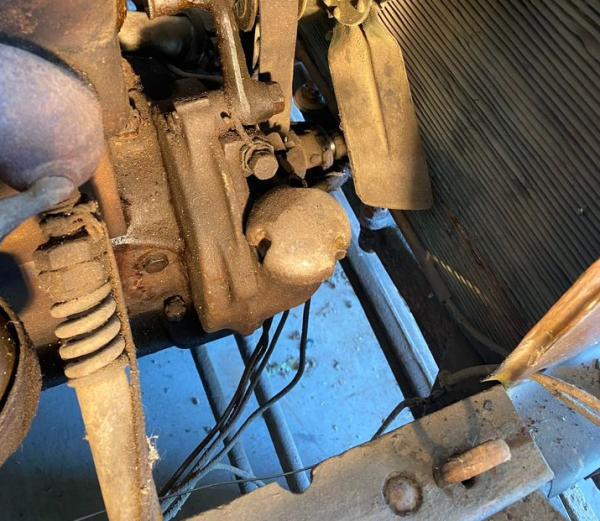

I saw this add on facebook marketplace . What is the springy looking thing near the oil can?

Don't know its only on this side. A motor vibration stabilizer ?

Accessory stabilization vibration strut. These mount to frame and press on the block to keep motor from shaking , or that is the idea anyway :D

Any improvement would be minimal. One thing I would NOT do is notch or drill the frame flange to mount any such contraption. As for vibration, you're not going to get rid of it in a T. Inline 4-cylinder engines vibrate, especially inline 4 cylinder engines with no crank counterweights. The T engine is a lightweight engine with large displacement and no crankshaft counterweights, no harmonic balancer, and a very limber crankshaft. It's gonna shake. The Model T is a lightweight, flexible car with virtually no vibration isolation of the engine from the frame or of the frame from the body. It's bound to shake. The design of the Model T chassis makes isolating engine vibration from the rest of vehicle a difficult proposition. The most practical method of minimizing powerplant vibration in a Model T consists of adding a counterweighted crankshaft, aluminum pistons, and balancing the engine and transmission. Beyond that, keeping all the other mechanical units as well as the wheels and tires in good condition will help reduce vibration, and keeping all body and chassis parts properly tightened and adjusted will minimize noise and other nuisances emanating from engine vibration and road defects.

It’s a torque reduction strut so when you gun the engine it doesn’t rip out the rear engine mounts…☺️
