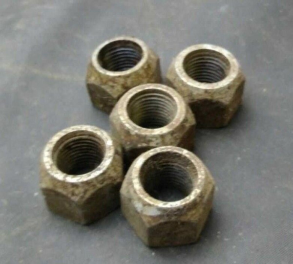

Re: Wire Wheel Lug Nuts - Question
The lug nuts are from WW 2 jeeps.  I have a couple of them and would be interested in buying the 5 from you if you are interested in selling them.  $1.00 a piece.
Thanks.
