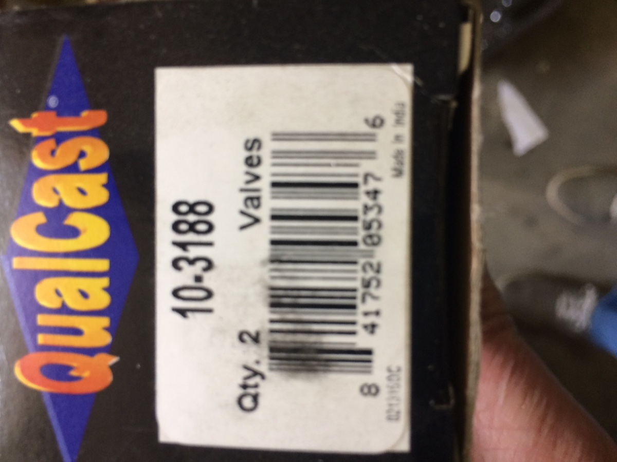

Also I modified Ford Escort exhaust valves if you need valves.
Les Schubert
- Posts: 1364
- First Name: Les
- Last Name: Schubert
- Location: Calgary
Re: Roof 16 head and domed pistons
I found a Mercedes Benz valve that fit about perfectly!!
Les Schubert
- Posts: 1364
- First Name: Les
- Location: Calgary
I used these valves
