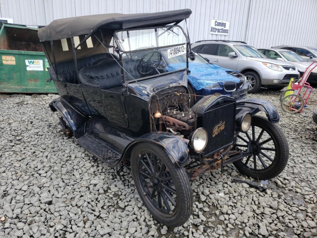

I came across this while I was looking for something else, it is listed as a 1931 Model T. Did/Does this belong to anyone here?

Boy, that poor thing took some hits...
that is one front axle which will not respond to the usual straightening!
Re: Salvage Model T, for auction.
Post by Norman Kling » Mon Oct 10, 2022 4:26 pm
Looks to me like a 1921. Not worth what they are asking, however I think it is fixable. Don't know whether the engine runs or transmission works. I would suspect maybe they needed to make a quick stop and hit the brakes and the rear wheel collapsed. The car then hit something in front of it.

Post by Mark Nunn » Mon Oct 10, 2022 4:39 pm
The asking price is off by a factor of 10.

Post by RajoRacer » Mon Oct 10, 2022 5:16 pm
Peculiar ! Body has 1925 door hinges ?

Post by Kerry » Mon Oct 10, 2022 6:05 pm
More like the transition from 22 to 23, still the 2 man top and straight windshield but with a steel firewall.

Post by Jerry VanOoteghem » Mon Oct 10, 2022 7:02 pm
Happy to see that the top, windshield and steering wheel are undamaged. Leads me to believe the driver got away fairly uninjured.

Post by Wayne Sheldon » Mon Oct 10, 2022 7:52 pm
I didn't waste much time on their website, other than looking at the photos. Certainly was a decent model T, but there was a lot not done properly.
It has a five panel rear tub, which makes it earlier, 1921 likely at the latest. The upholstery is not done properly. The material should have been rolled over the tack strip's edge and nailed from underneath, and the step over should be obvious. It isn't. Some of that might be explained by the upholstery being over-stuffed. The steel firewall would have been changed at some point as they weren't available until late 1922. Rear doors have proper offset hinges, front door has 1925 only equal hinge. (As already mentioned!)
Radiator appears to be an era after-market honeycomb.
Detailing is so-so, perfect for a driver/tour car. But not for a top dollar car!
Website lists "cash value" at 22K! At best, the car was worth half that before the crash.
MOST of the collision damage is at the front of the car. Interesting that a rear wheel was broken. I am curious about the details of the wreck, causes etc. Wooden wheels are often broken as a result of accidents. Unless there is significant previous damage to a wheel, wooden spoke wheels rarely cause accidents. I wish I could spend an hour examining the wheel to try to determine the cause of the breakage.
Frame is likely bent (maybe badly?). Pan will require straightening! Body may be okay, rear fenders, side aprons, running boards and many other pieces may only need minor repair. Rear end will need to be checked out. Front end should be junked and replaced. Front fenders might be worth repairing.
It would be fairly easy to return this car to the road and be again a nice tour car. A really nice right car would take a lot more work. I could see this being worth about $5000 as is. Of course, I probably have every piece needed to fix it!
Other states will be different. In some states, ANY title is a good title! Here, salvage titles are not something you want to deal with. Replace the frame and front end, generate a replacement title for that, and part out this car to restore your generated title car! Most people that write laws are idiots. (Or have ulterior motives!)

Post by ironhorse » Thu Oct 13, 2022 12:16 pm
I would have to do a lot of research before buying a car off of this site I looked around and found that their "actual cash values" are somewhat inflated! :lol:

Post by Pep C Strebeck » Thu Oct 13, 2022 12:27 pm
I believe that the "Actual Cash Value" that is shown in the listing is just an auction estimate or what they "think" it should bring. The actual "Sale Status" of the vehicle is listed as being "On Minimum Bid", whatever that would be once the auction actually starts.
Jerry said it well, with the lack of damage to the top, windshield and steering wheel it looks as though the driver may have gotten out fairly uninjured.

Post by Steve Jelf » Thu Oct 13, 2022 12:35 pm
Yes, the "actual cash value" is a joke. The 1923 firewall and 1925 hinges suggest it might be a complete parts salad. There's no water pump, so the radiator may be OK.

I wonder if that car was being moved in a trailer that was involved in a low speed accident. It looks as if the right front spring hanger might have broken, perhaps when the front wheels contacted whatever flattened the fenders. If so, it may have spared the axle and frame from serious damage. The front fender damage looks as if the car bumped straight into a smooth, flat wall, like the front of a trailer. Perhaps the tow vehicle hit something almost head-on, and then then trailer jackknifed, putting a side load on the right rear wheel, causing it to collapse. The top alignment and right side doors look pretty good. It could even be damage from an improper tow hookup.
