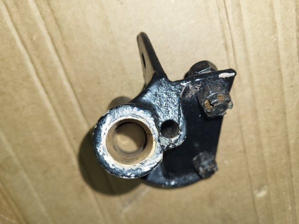

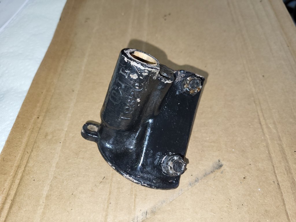

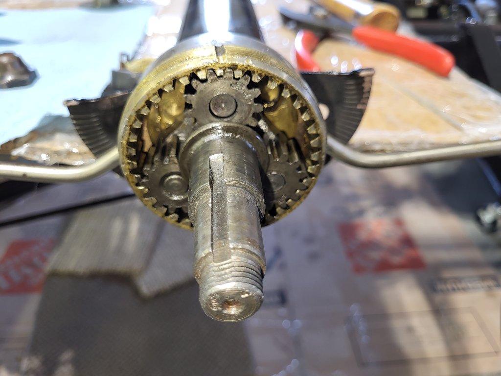

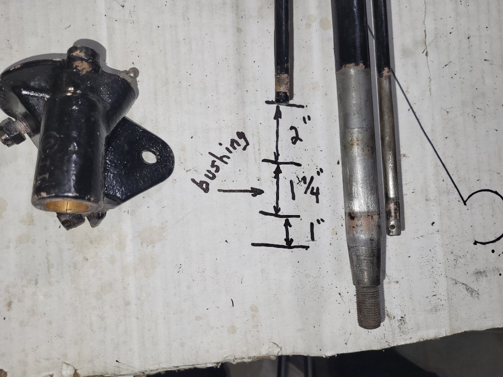

I am trying to determine if the bushing at the end of my steering shaft needs to be replaced. I made measurements of the inside of the bushing and on the shaft.
Bushing measurements: 0.757, 0.766, 0.754, 0,760 (ave. 0.759)
Shaft measurements: 0.750, 0.746, 0.745, 0.744, 0.745 (ave. 0.746)
0.013 difference.
Photos attached. Forgot to take one of the shaft.
Need opinions!

In view of the comments, I measured the shaft in the 1" length between the pitman arm and the bushing area. I also measured the shaft in the 2" length above the bushing. I remeasured the bushing and the shaft under it. See the attached photo.
The six shaft measurements in the 1" length are 0.750-0.749-0.748-0.751-0.752-0.751 (ave. 0.750)
The six shaft measurements in the 1 1/4" bushing length are 0.744-0.742-0.743-0.748-0.746-0.746 (ave. 0.744)
I made measurements in the 2" length above the bushing but forgot to write them down. They were about 0.750.
The three ID measurements of the bushing are 0.758-0.756-0.758 (ave. 0.757)
(1) ). The existing clearance is 0.013 (0.757 minus 0.744).
(2) It appears the shaft has worn 0.006 (0.750 minus 0.744).
(3) Replacement bushings are 7/8 x 3/4 x 1 1/4. I assume the original bushing was that size and was reamed to an ID of
0.751/0.752 or more. Is that a reasonable assumption?
(4) It appears the bushing has worn .005/0.006 (assuming that the original ID was 0.751/0.752).
(5) The ID of a new bushing would need to be at least 0.752 to get bracket into position on the shaft as is. Therefore,
the resulting clearance would be 0.008 (0.752 minus 0.744), not much of an improvement. This the point Jerry
made!!!
In Summary: I am not capable of machining the shaft or removing and installing a new bushing. Obviously, I could take the items to a machine shop and have it done, and I will do that if it is really necessary.
If the shaft, in the 1'' length and bushing area, is machined to 0.742 is there a bushing available that can be reamed to accommodate the shaft?
The question I have is: If I live with the existing condition, how will it affect the steering?
I am replacing the pitman arm.

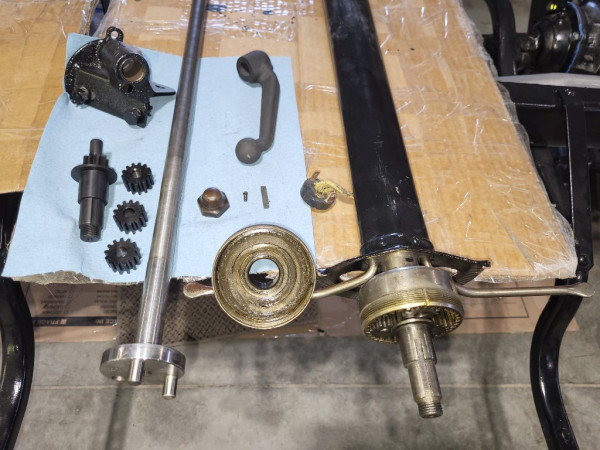

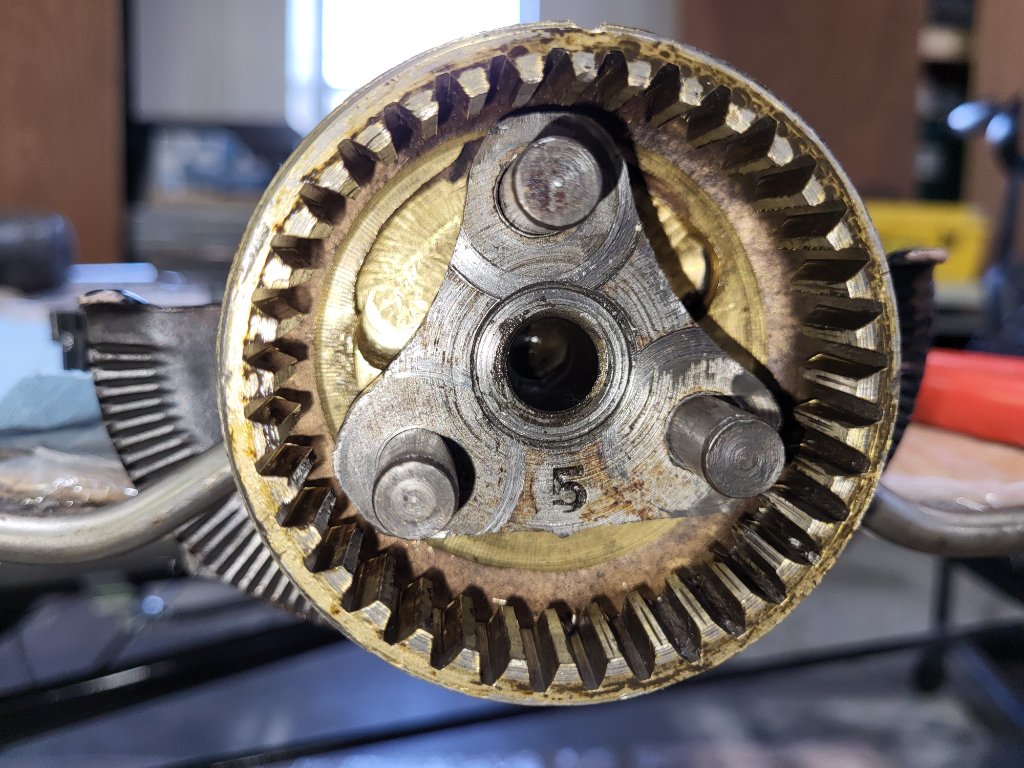

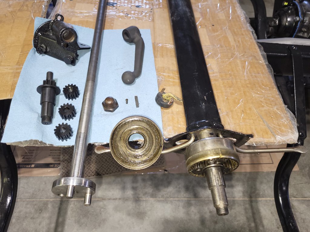

I decided to replace the steering shaft. The condition at the end of the shaft is more than I wanted to deal with. The items at the head of the shaft appear to be in good condition, as shown in the attached photos, and could have been reused.
The last photo shows the new shaft, gears, bottom bracket with new bushing, and new pitman arm.
