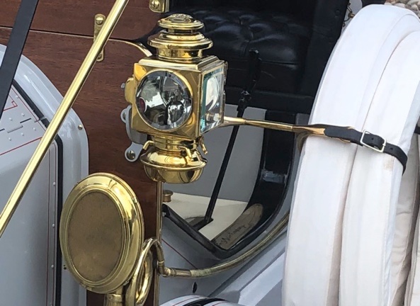

Does any one have a picture of how the brass tire carrier for the running board mounts.

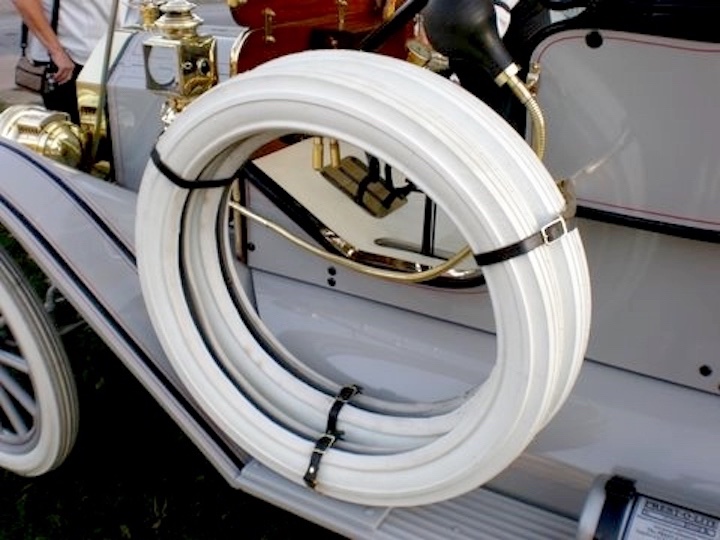

Here is one way to install. The twin brackets fitted to a board, painted to match body, with the board bolted to the existing running board bolts.
Each bracket holds a tire at the base with a leather strap.
Dual leather straps above hold the two tires together.

ok if the 2 small ones go on the board where does the larger bracket go.

The longer bracket for the upper cradles a tire, the long male spade portion is mounted to the dash.
