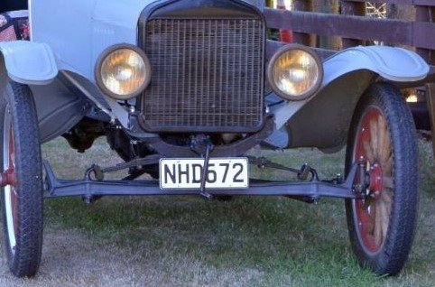

Post by Steve Jelf » Tue Oct 18, 2022 4:04 pm
Buy or make an aftermarket license plate bracket. It's held by the front spring clip nuts.

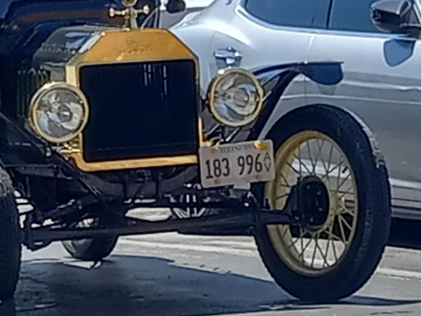

Post by A Whiteman » Tue Oct 18, 2022 4:47 pm
Bracket in use:
2021-02-10 (2).jpg (71.66 KiB) Viewed 2264 times

Re: license plate
Post by speedytinc » Tue Oct 18, 2022 4:51 pm
The motor mount is different on a correct 16 than Steve shows. Shown is the later motor mount 2 nuts attaching. The 16 has 2 u bolts holding the motor mount & springs.

Re: license plate
Post by speedytinc » Tue Oct 18, 2022 4:53 pm
Bracket in use:
Again this is a later T.
The motor mount for a 16 is very different making the license plate mount very different.

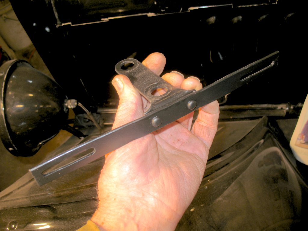

Post by WayneJ » Wed Oct 19, 2022 3:30 am
To avoid interference with the crank, I mounted my front license plate below the Headlight, as in this period photo:
To achieve this look, I used this type of bracket:
IMG_2651 copy.JPG.jpg (45.31 KiB) Viewed 2103 times
I enlarged the first mounting hole and attached the license bracket to the bottom end of the headlight bracket, as so:
