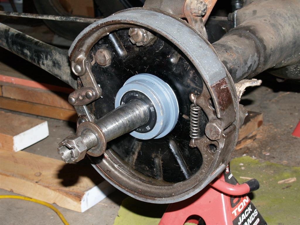

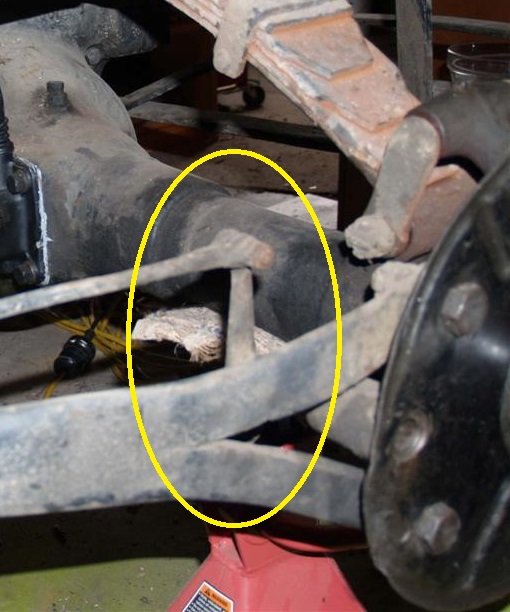

Well, a picture is worth a thousand words. The position of the cam and links is about per this picture. Left and right are the same - i.e. the cam 'leans back' on both sides, and top link angles back as well. When the rod pulls forward it pulls the cam and expands the shoes.
(the grey painted seal carrier is home made - works fine :-) )
The lever should be vertical like this: The teeth at the end of the lever allows some adjustment (see Martynn's diagram): https://mtfca.com/phpBB3/app.php/gallery/album/59
YOU MAY BE ABLE to adjust the lever so it 'leans back' a little if your rods are a little too long. Don't lean it back too much or you lose leverage.

"straight up" bellcrank should be when the brakes are fully engaged, and when released, the bellcrank should be laying backwards

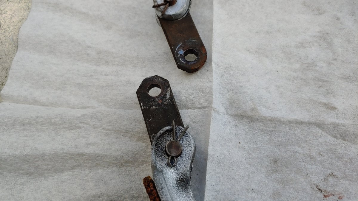

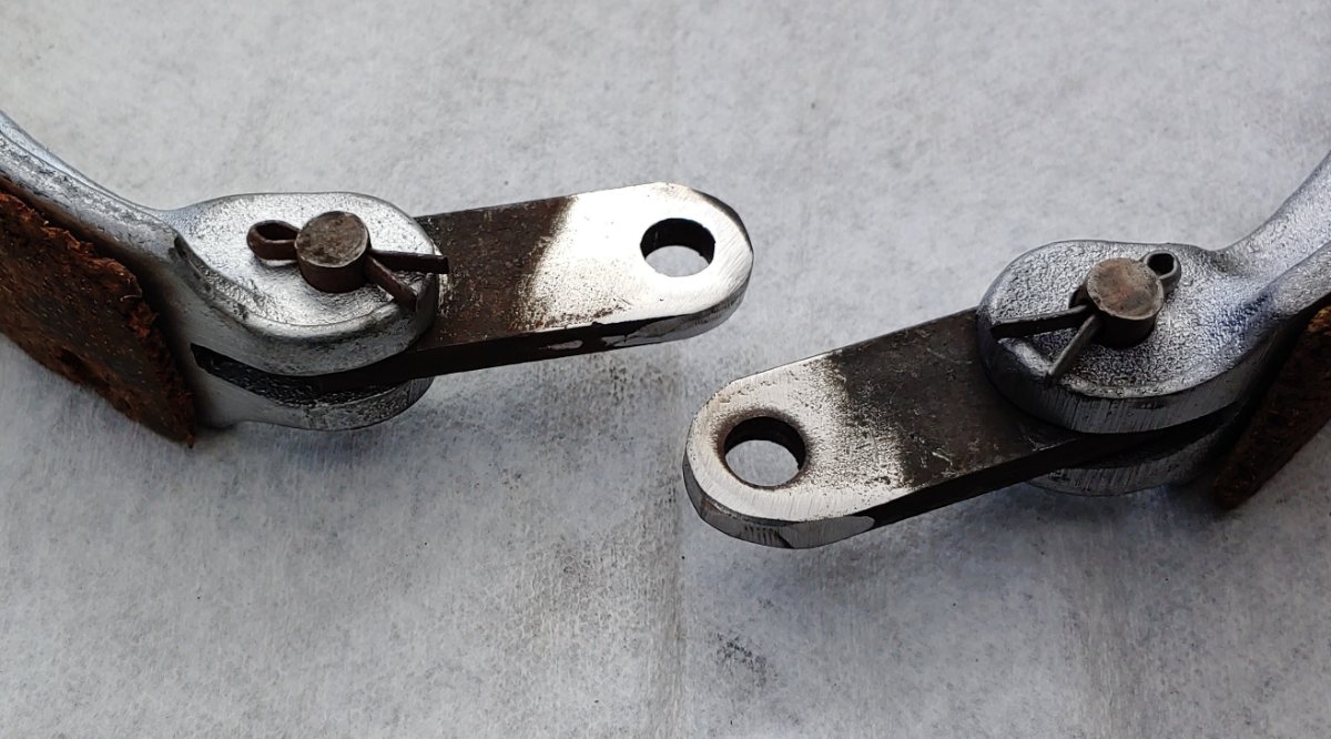

As Promised:
First photo: Brake links AFTER being ground round on the ends.
Second photo: Brake links as supplied with the cut ends.
Third photo: After ground and installed. NOTE: You will be able to see the top shoe sitting down on the spring perch nut. This is as far open and it will ever go without modifying the perch nut.
I hope this will help someone in the future. I know some of you will remember and pass this info on. Thank you for doing so and you have my full permission.
Good Luck,
Terry
