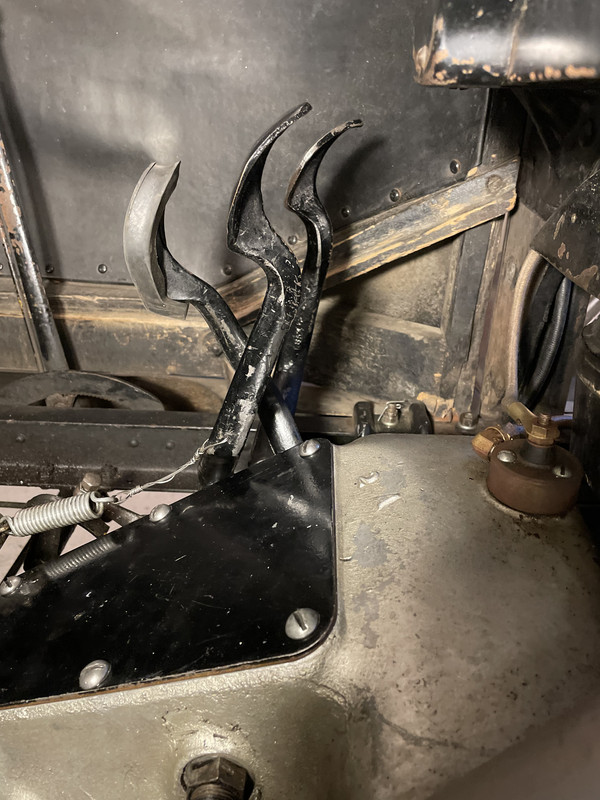

This maybe a crazy idea, but has anyone ever tried/found a way to change the position of the low speed pedal itself to give more pedal travel when engaging low before you hit the floorboard?
I use Kevlar bands and a few years ago I cracked my low speed drum - I am terrified of doing that again. What a headache. Anyways, after a rebuild, some driving and a set of new floorboards last summer I’m finding the low speed pedal doesn’t quite grip like it should.
I am having no luck at all finding a position where it doesn’t drag when the clutch is out (in “neutral”) but still has good grip in low. Obviously either dragging in neutral or slipping in low risks another cracked drum (not to mention the poor low speed performance makes pulling out into traffic that much hairier), but I can’t seem to find a happy medium.
One issue is that when I have it in a spot where it doesn’t creep in neutral, once I put the floorboards in I’m finding the pedal hits the floorboard before it reaches the end of its travel. Meanwhile, when it’s in high gear there’s a comfortable inch or two of room at the bottom end of the floorboard slot.
I was thinking that a simple (?) fix would be to find a way to just adjust the position of the low-speed pedal on the shaft, so that the pedal is angled a little further to the rear of the car. This would give plenty of travel for the low speed cam AND let me leave the band nice and loose
Has anyone ever done this? I don’t see any obvious adjustment point (just the one tapered pin). I was wondering if I could heat it up with a blowtorch and try bending it in a vise.
Am I crazy?

You didn't install a new notch and pedal support in the hogs head, did you? Everything you stated can only lead to that conclusion...either that or the bands are horribly out of round, but I'm betting on a worn out hogs head being the primary cause for your trouble.
you don't want more forward pedal travel...you want LOTS of sideways "cinching" movement when the pedal goes forward. You can have enough forward movement that the pedal will ride up to the maximum sideways movement and still keep moving forward (with no more band tightening) if you play with the floorboards or the pedal angle enough, but that is NOT what you want.
If it is dragging in neutral and only taking up with extreme forward pedal movement, then sad to say, you are on a fast trip to replacing another drum.

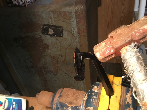

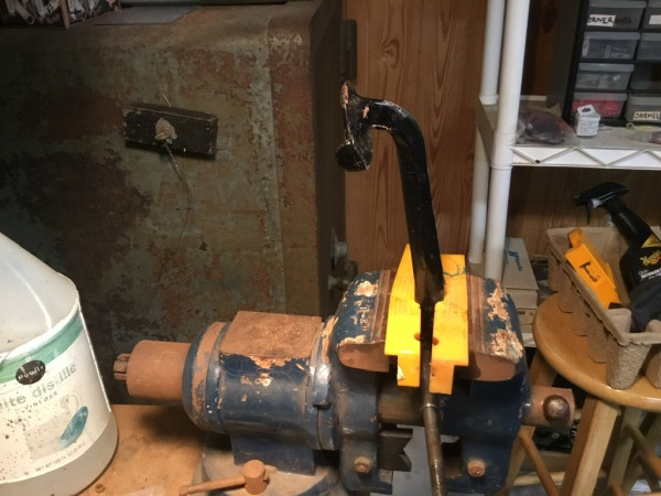

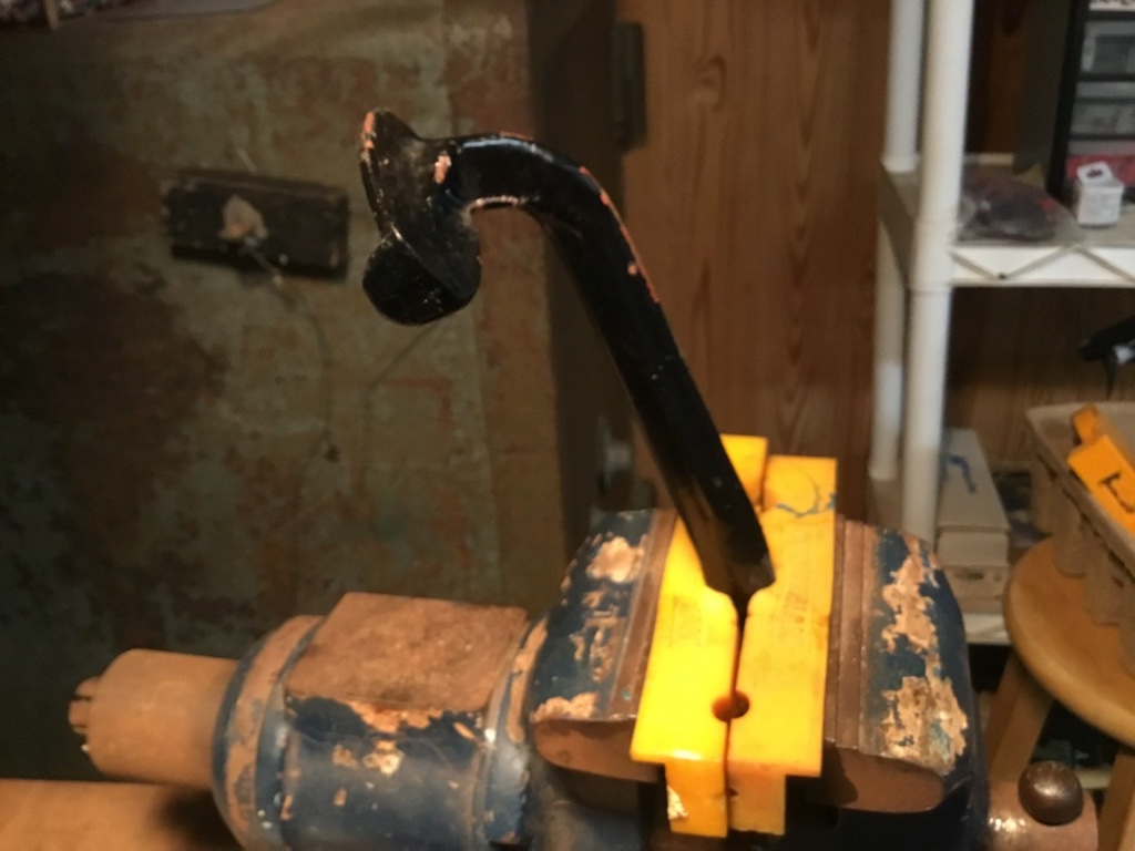

My brake pedal would bottom out on the floor board so I took it off, put it in a vice and hit it several times with a small sledge hammer until the angle was changed enough to give it a 1” space from the floor when fully pressed. I suppose the same could be done with the low speed pedal. Jim Patrick

Straighten the low speed pedal. Sure sounds like it is bent forward and needs to be pulled back. This can be done in the car cold or with care some heat

If the hogshead has had a new first gear pedal
and ramp fitted, there should only be 1.5" of free play with which to hold the clutch disengaged with your foot. Any more than this indicates that the pedal/ramps are worn.
On our RHD cars the ramp can easily be replaced, but the pedal needs to be removed from the shaft, the ramps need welding to rebuild them, and the a deal of time has to be spent hand working them back into shape to match the ramp.

I think it’s definitely the pedal. When adjusted as suggested I have no creep but need to hit the floorboard to have any grab. The cam is definitely new - not even close to camming out. And looking down the side of the pedals, the low speed rests far forward of brake.

As much of the pedal as I can see looks OK. Proceed with caution.
