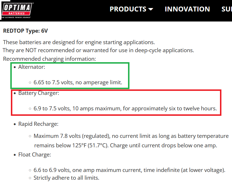

From the this web site https://thebatterybase.com.au/how-to-re ... y-charger/
Will my high-output alternator damage the OPTIMA battery?
No, as long as the voltage is properly regulated. Because the Optima battery has a very low internal resistance, it will accept high current more efficiently than conventional batteries.
Form the optima site https://www.optimabatteries.com/charging --
Again it is the voltage, not the amperage, that is used to charge the battery. So the ammeter is reading the load on the system, the battery being charged is one load and the headlights being on is another. Say 10amps for the battery & 5amps for the headlights = 15amps. Then when you turn the headlamps off it should drop Note the 10 & 5 are assumed values.
