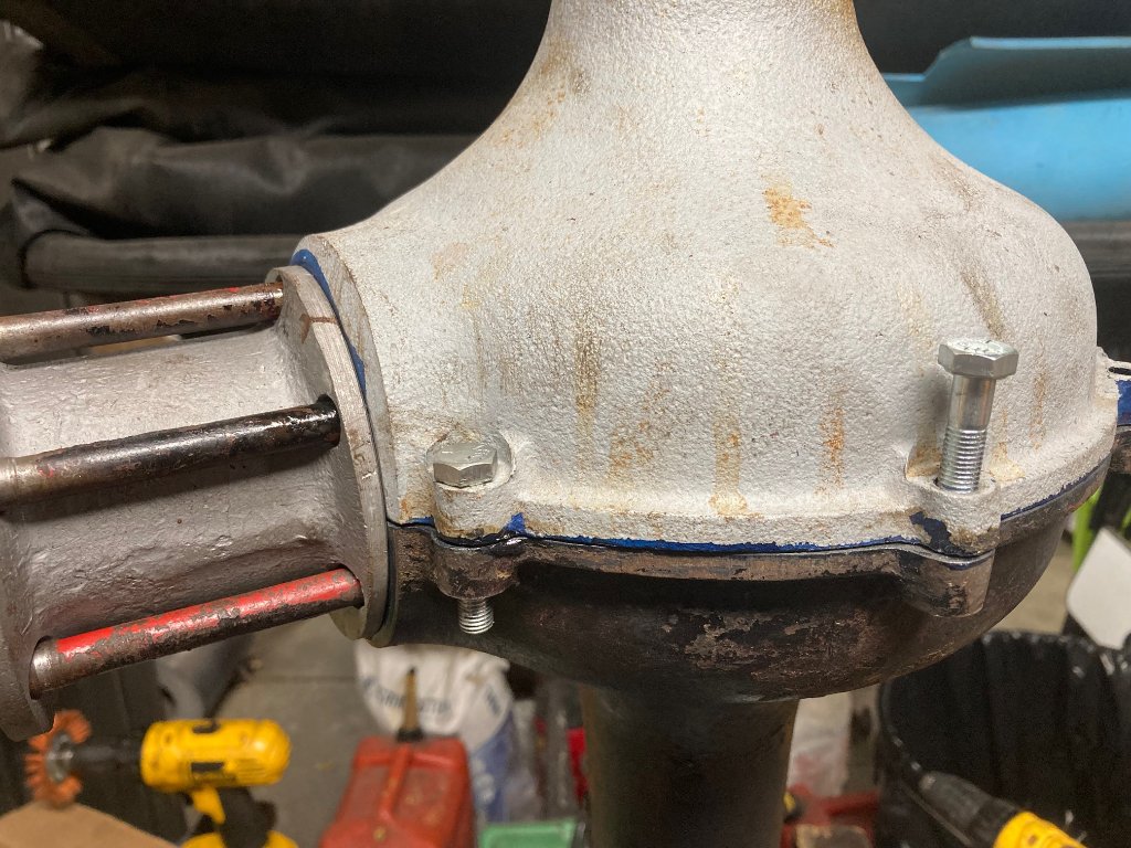

I'm rebuilding the rear axle in my 1927 Touring, one of my axle housing on the outside end must have worn through the bearing sleeve an into the axle housing, I have a spare, but when I put the two halves together the only bolts that line up are the ones next to the Drive shaft roller bearing housing.
Are all housing created equal or should I be looking for something specific? The axle housings I have all have he large drum backing plate on them.

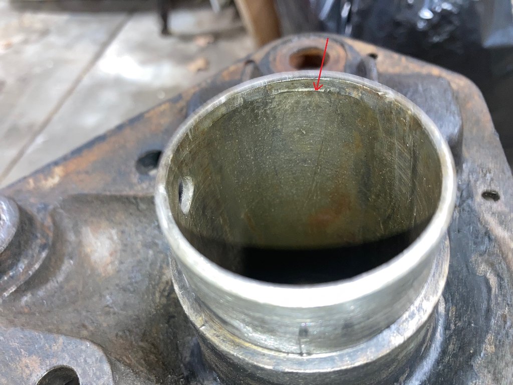

Second picture is my old worn axle housing, maybe that's okay to use, I don't know.

I'd use the old one. The bearing sleeve won't be affected by the lip if you carefully grind it smooth
- Posts: 4496
Re: 1927 axle housing alignment
The lip would not be the issue. The lip appears due to inside diameter of the axle tube being worn out-of-round below the lip. Installing a new sleeve in that housing would either create a void between the sleeve and the housing, or would force the sleeve to also be out-of-round. Ultimately, under load, the latter condition would be the result.RGould1910 wrote: ↑Fri Nov 25, 2022 11:17 pmI'd use the old one. The bearing sleeve won't be affected by the lip if you carefully grind it smooth
bmklawt
Topic author - Posts: 235
- Joined: Sun Jan 13, 2019 8:13 pm
- First Name: Bruce
- Last Name: Klawiter
- Location: Holland MI
Exactly what Jerry said, tube is out of round.
Can I chase the mounting holes for the axle half's with a drill or should I be looking for a better fitting axle housing?
- Posts: 4694
Do you have the housing for the other side of the one which does not fit? If so, how does it fit and in what condition is it. Maybe good to replace both sides or to look for a better one at swap meets. You would be surprised how forgiving a T is for small imperfections. You might even be able to put in a thin shim at the low point between the housing and the sleeve. If you are using the original type bearings which are hollow like a spring, they will flex a bit but I don't think solid rollers would be as good to use in this application.
RGould1910
- Posts: 1244
- Last Name: Gould
- Location: Folsom, CA
I don't think the lip was created by a bent axle. The sleeve covers that area and any tweaked or angled condition would not have caused wear under the sleeve. Even if the sleeve were recessed in the axle housing, I don't see how the bearing cage could have reached the tube to caused the wear we see. The lip was likely caused by a cup washer rubbing against the inner surface of the housing coupled with a recessed sleeve.
RGould1910
- Posts: 1244
- Last Name: Gould
Looking at the photo closer, it's the sleeve that has the lip, not the tube. I agree its due to a bent axle housing. A very common condition. Most all rear end housings I see are bent. That doesn't seem to affect drivability unless the bend is extreme. Most folks replace the sleeve and are done with it. There are a number of threads on straightening rear axle housings if that's what you want to do. I've done a number of them myself.
- Posts: 4496
There is no sleeve in that tube. The sleeve that WAS there wore completely through, allowing the bearing to then begin wearing away at the axle tube itself. Nobody suggested this was due to a bent axle housing.RGould1910 wrote: ↑Sat Nov 26, 2022 8:17 pmLooking at the photo closer, it's the sleeve that has the lip, not the tube. I agree its due to a bent axle housing. A very common condition. Most all rear end housings I see are bent. That doesn't seem to affect drivability unless the bend is extreme. Most folks replace the sleeve and are done with it. There are a number of threads on straightening rear axle housings if that's what you want to do. I've done a number of them myself.
