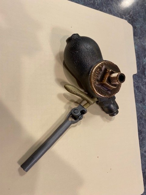

I have read a number of solutions to the problem of extending the fuel shutoff handle from under the car to the outside. For sure the passing of time makes the trip to the ground and to the center of the car further with each birthday and I now find it a quite a chore to make the journey. As a result I often leave the fuel valve on, risking a leak and a fire, even though I know better. I have made a few "universal joint" attempts to alleviate the problem but never was satisfied with the "fit and finish" or the operation of any of my creations. Last night, brainstorming the issue, I came to the realization that a '26, '27 carb adjustment universal might be the answer. I had an old one and proceeded to saw off the needle valve end flush with the threads and cut off the ears that provide tension to hold the adjustment. I then chucked up the valve from the "potato" and drilled a #3 hole into the handle end about 3/4" deep followed with a 1/4-28 tap. A drop of locktite secured the new universal joint to the valve and tonight I will extend the yet to be made handle to the exterior of the car body. So far my investment is zero and the time spent was about fifteen minutes. Simple but practical and still 100% Model T.

let us know how it works. That u joint seems a bit small and weak for the job. I leave mine on all the time and have a valve next to the carburetor which I can reach under the hood which I turn off when parked. Only time I use the one at the bulb is if I am working on the fuel line.

I like the U-joint idea. That should work. Let us now how it works out.
