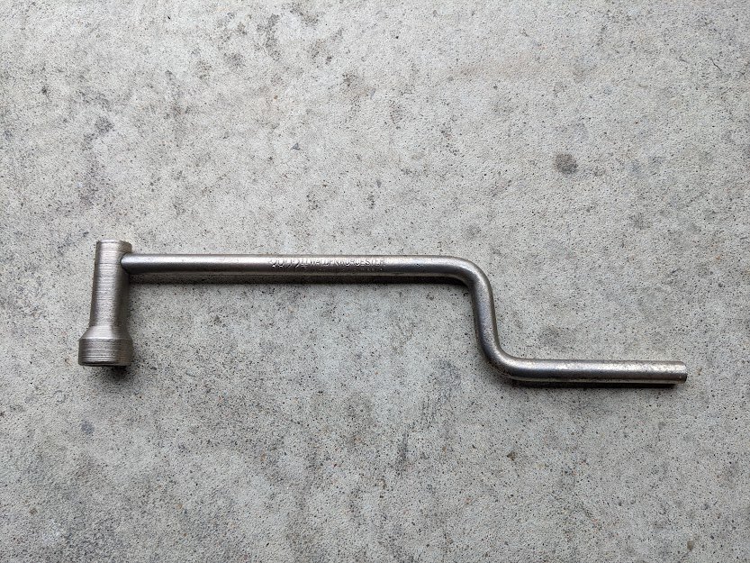

I agree on both accounts Neil - I'm fortunate enough to own an original St. Louis tester and that Blackhawk flywheel wrench in the best available !
- Posts: 4684
Re: Way to check magneto during engine buildup
I also have one of those Blackhawk flywheel wrenches . They do work really well.

I have a set of 3/8 dirve sockets with universals made by Bonney tools. They work great for the multiple times you need to lift the assembly to set clearance. I also have the Blackhawk tool for final tightening. They are similar to these. https://www.amazon.com/stores/TEKTON/Un ... 37C1C1C56E

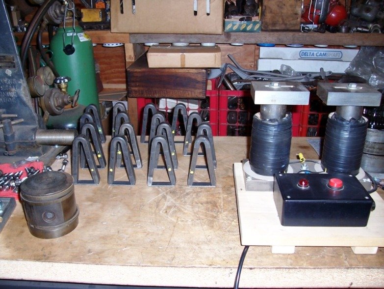

Ron Patterson owns an "era" magnet charger - it's a monster ! I built mine (with help) from the David Gingery "how to" book - it will saturate a T magnet in 3 seconds to hold 4+ lbs. - it runs on 110 v. I used to use a cast iron piston w/pin - now I have a 4 lb. piece of square stock.
- Posts: 5254
WOW, thats a magnet charger.

Didn't lose any fillings John BUT my electrical engineer buddy that did the circuits & wiring told me to stand on a rubber mat to "smoke test" it, which I did but not clearing some hand wrenches off the bench top caused me to almost pee myself when everything in close proximity flew towards the charger ! No smoke though !

RAJO. You hold the power on for 3 seconds. Do you think you get a stronger charge as opposed to 1 flash.RajoRacer wrote: ↑Fri Sep 23, 2022 5:30 pmDidn't lose any fillings John BUT my electrical engineer buddy that did the circuits & wiring told me to stand on a rubber mat to "smoke test" it, which I did but not clearing some hand wrenches off the bench top caused me to almost pee myself when everything in close proximity flew towards the charger ! No smoke though !
I did some experimenting using a starter cable ammeter to read magnetism. On different magnets, I tried 1 flash, multiple flashes & a hold on for 4-5 seconds. I could not read any difference between the 3 methods. The hold on method created heat in the coils.
I do 3 or 4 flashes typically. Even with evidence any more than 1 flash is unnecessary, I cant help myself.
That unit must create immediate saturation on a magnet.
- Posts: 5594
I stand the T magnet on end for the first 3 second flash then lay it on it's side and slightly tap the horeshoe end with a brass hammer whilst holding the button down for another approx. 3 seconds. All the magnetism books I've read states that tapping while charging aligns the molecules more uniform for a stronger charge. I can do about 10-12 magnets before the coils get warm enough.
