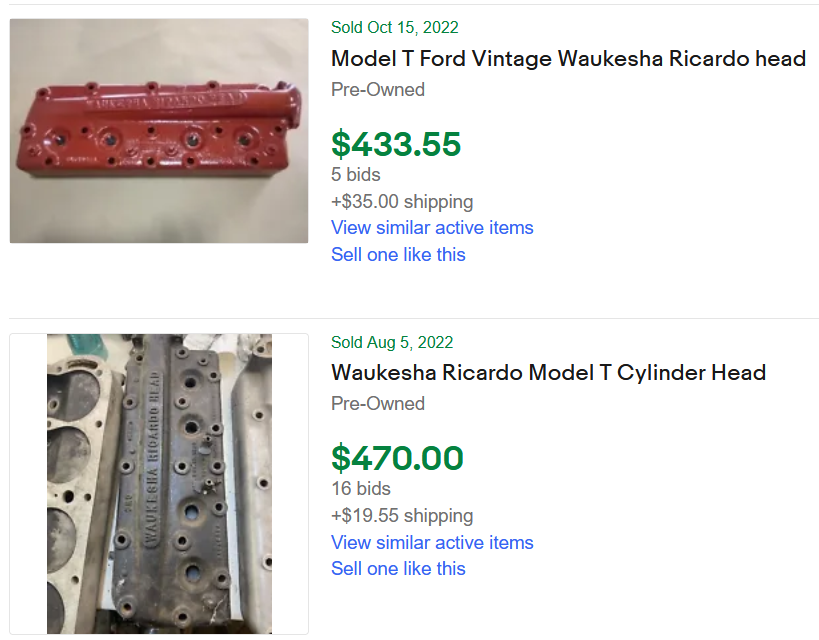

A good buy is $300
A good sale is $500 and would have to be near perfect and maybe even freshly surfaced

Scott's right on - sold on eBay

The WR head on my centerdoor makes it scary fast.
I’d buy another for $300 but wouldn’t sell this one for $500 so I agree - again - with Scott.
