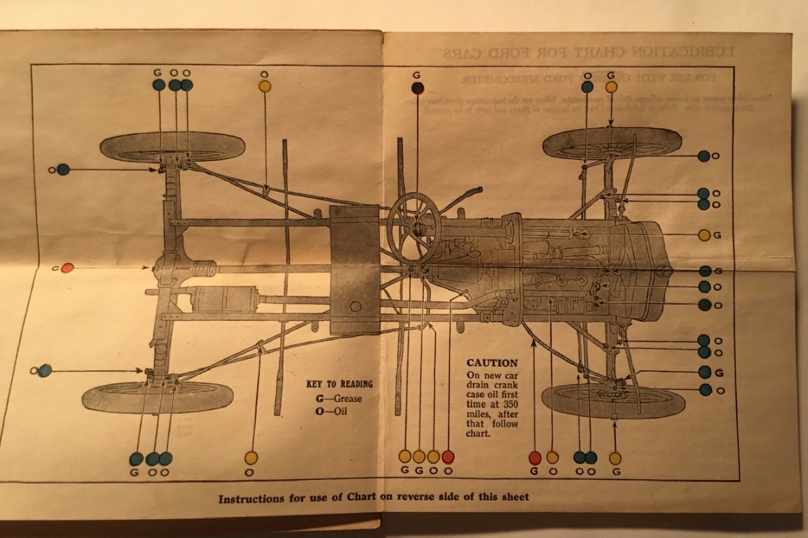

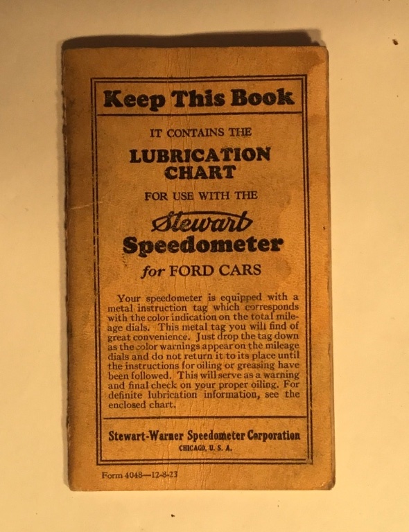

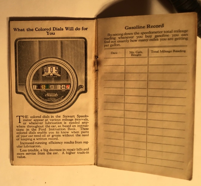

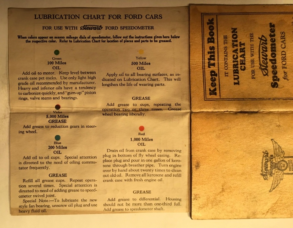

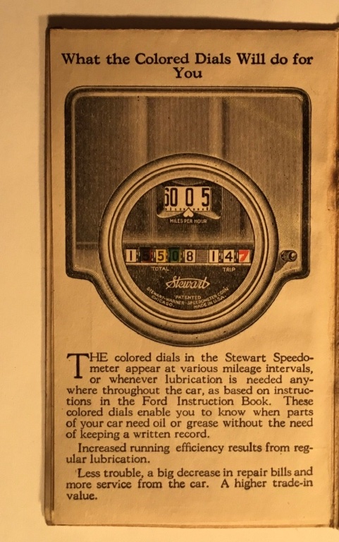

There have been a lot of speedometer threads lately and I have an original Stewart speedometer booklet that went with the Stewart 160 with the colored numbers that correspond with the type of maintenance that comes due when the colored number comes around. This booklet was necessary to determine which color matched the type of maintenance depicted on the fold out diagram of the Model T chassis, with each lubrication point marked with the specific color of the colored numbers. Jim Patrick

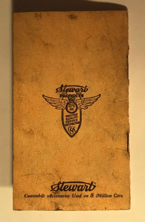

Back cover
