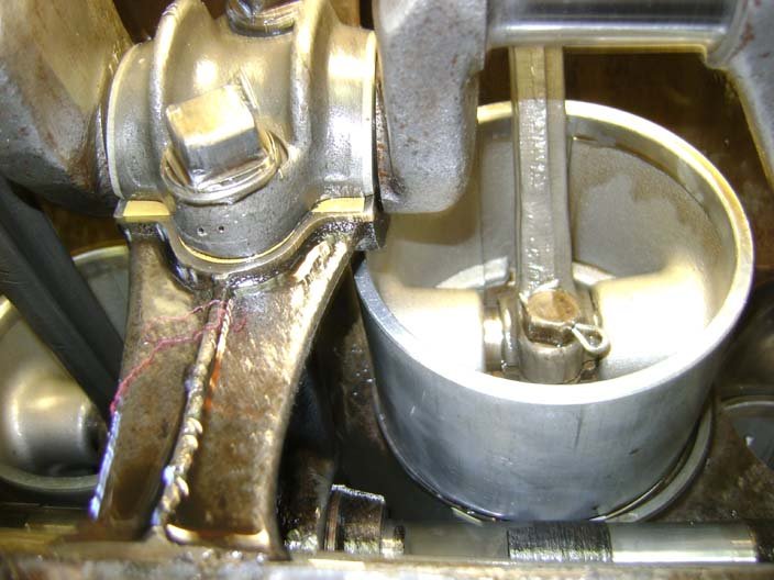

I got careless (stupid) when adjusting my rods, putting oil in the caps but neglecting to fill the rod dips before starting. At about 30 seconds a loud knocking occurred. Pulling the inspection pan revealed #3 rod was loose and had damaged babbit. The journal looks pristine, and the other rods are tight. The engine is now out of the car. Due to the difficulty getting head gaskets, as well as wondering if it is difficult, I ask if the rod can be replaced through the inspection pan without pulling the head or should I just pull the head?

The number 3 rodcan be changed through the bottom. Be careful to not bend the rod when wrenching the wrist pin bolt

I replaced the #1 rod in the car in a motel parking lot. Not fun and don't let the bottom ring come out of the cylinder but it can be done. Do be careful tightening the wrist pin bolt.

I tried to replace one with the head on once. Bottom ring popped out and piston was jammed against the center main bearing.

Been a while since I did a rod change like this.(during a national tour, day 1. There's a whole story there.)
I believe I turned the piston to where I could put a long bolt thru the wrist pin to hold for tightening the wrist pin cinch bolt.

I replaced no 1 rod in Henrietta, through the inspection pan. It was done on a hoist to make it easier. I did not want to disturb her any more than is essential, so pulling the head was ruled out.
A used rod with sound Babbitt, was filed, scraped and lapped with timesheet. The wrist pin was held in place with a piece of rod inserted, which registered on the web in the block. The only tricky bit wad compressing the bottom ring on the cast iron piston enough to get the piston back up the block.
I repeat, the whole job was done in this manner just to preserve the original appearance of the car. Otherwise, pulling the head is the way to go.

In my view there's no reason to take the piston and rod out the top if all you want to do is replace the rod. It's easily and more quickly achieved out the bottom, and you won't require a new head gasket - and as long as you only cemented one side of the pan gasket you shouldn't need a new one of those either.
In doing this I'd expect the bottom ring to escape, you can get slim 'clip' style ring compressors but I have simply used a large jubilee clip (hose clamp) with good (and inexpensive) results. Unless something untoward occurred you should be able to get the job done within an hour.

In follow up, I was able to remove the #3 rod through the inspection port fairly easily. I put a bolt through the wrist pin and rotated the piston so that the bolt contacted the block to avoid twisting the rod, and removed the wrist pin bolt. I slid the wrist pin partially out with a long L shaped allen wrench, and removed the rod. With the engine out and the inspection pan out, I don't think it took 15 minutes. Unfortunately, the replacement rod I ordered and received today is non-Ford and is 83 grams heavier, so I am awaiting getting my Ford script rod re-babitted and bored to my .015 under rod journals. I checked the other 3 rods and they are all Ford script. Oh well, this gives me time to fix the axle I broke on the Ohio tour.
