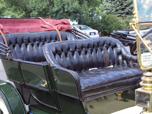

Hi all, just a few questions about my upholstery project.
1. Button spacing seems to be 3" on center for the front seat back, and 3 1/2" on the front seat bottom.
The rear is 3 1/2" on center for the back and bottom.
It's been a few years since I've done tufting, I had several books with layout patterns but after two moves they've run off , I'm sure it was gremlins.
Does anyone have a layout pattern? The buttons on the 09 touring I looked at seem to be 9/16" is this correct?
How many square feet of hide?
Any help appreciated.
By the way, Keith I've finally found the 1911 patterns, I'll send them off right away.
Mike

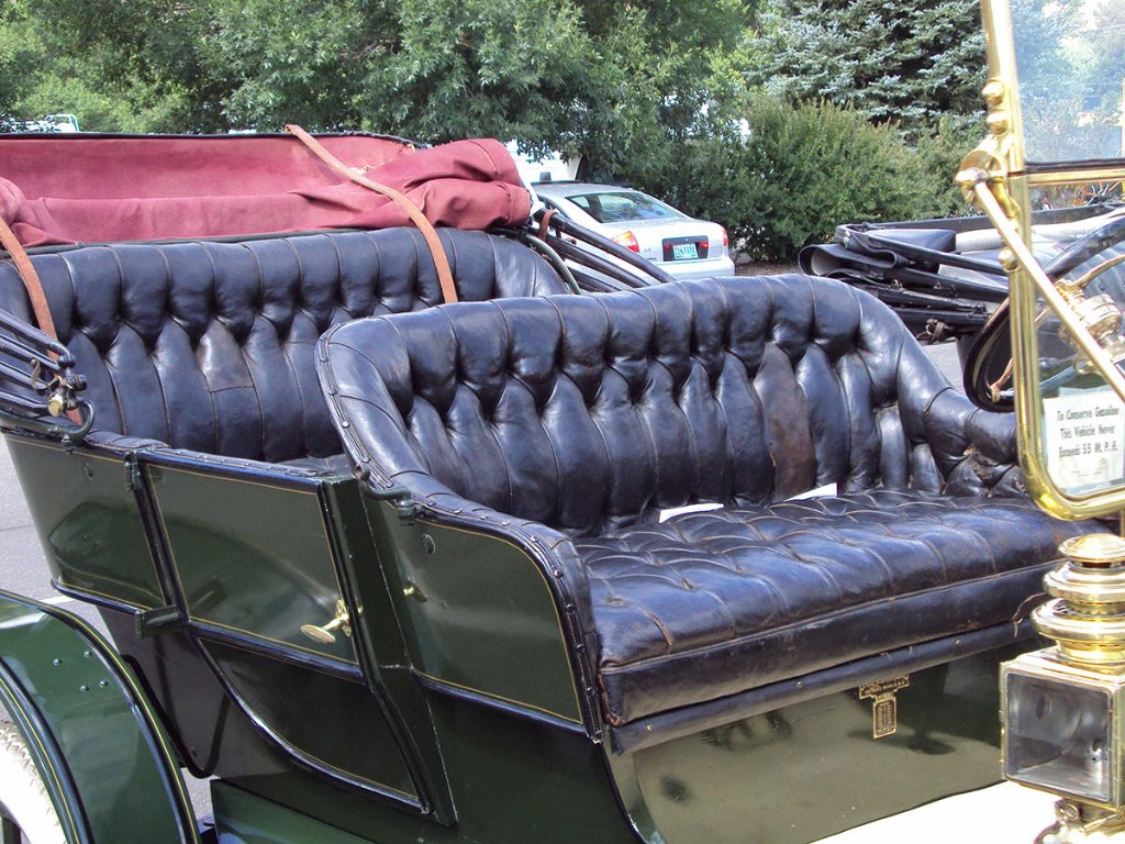

Post by Rich Eagle » Sun Oct 23, 2022 12:46 pm
This is Dan Logan's original '09.
I don't know if it helps any but here it is.

Yes, thank you Rich.
