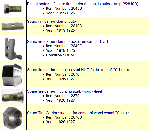

I'm going to look again in my pile of nuts that came with he car first. If not I'll order some. Not sure why I couldn't find them on Lang's WEB page. Thanks everyone!!

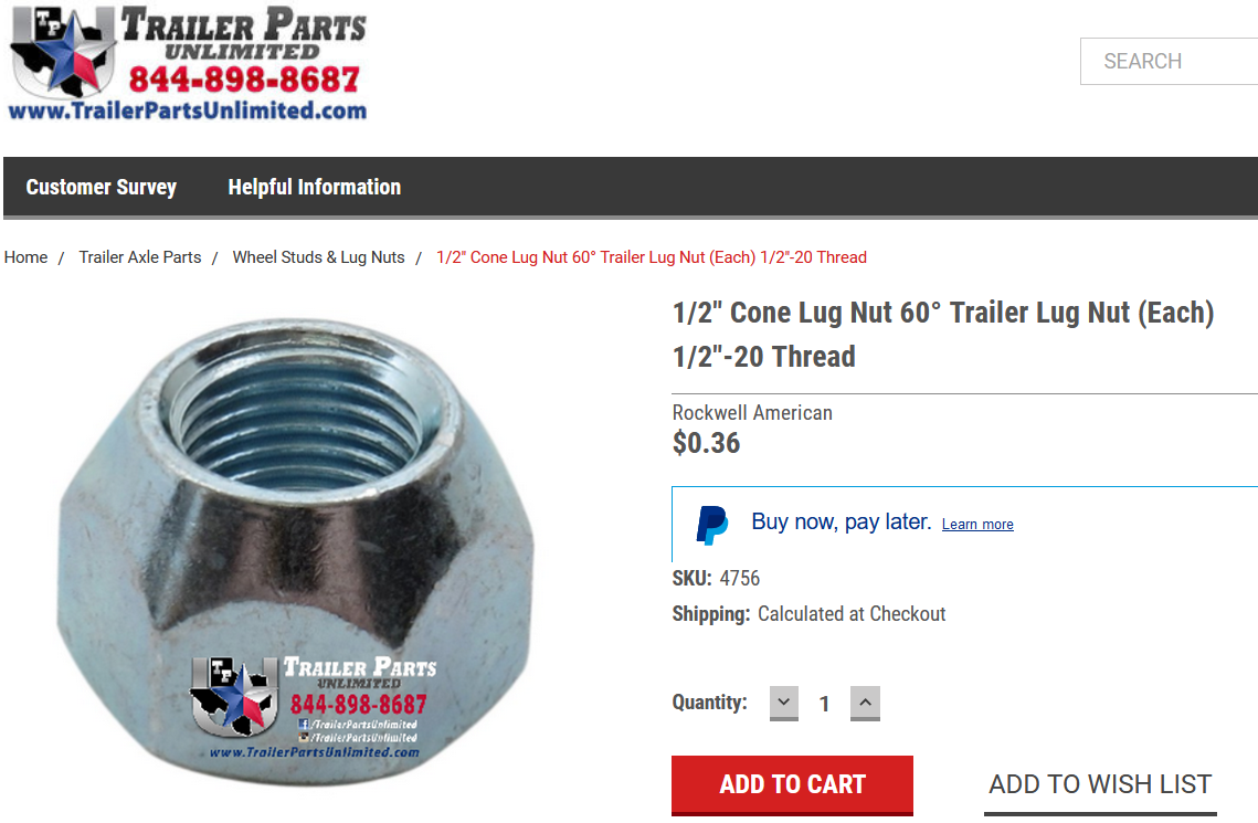

You may also be able to find these nuts at an automotive parts store in the Trailer parts section 1/2"-20 Thread with 60° cone
But searching costs time & gas ($). I assume that the top shorter height nut just needs to be flush with the stud

I apologize Frank - it seems as though Lang's does carry a facsimile !

Post by Mopar_man » Tue Nov 08, 2022 12:38 pm
Thanks Frank. I called Lang's they have them on backorder. I'm going to try the place you got the picture from.

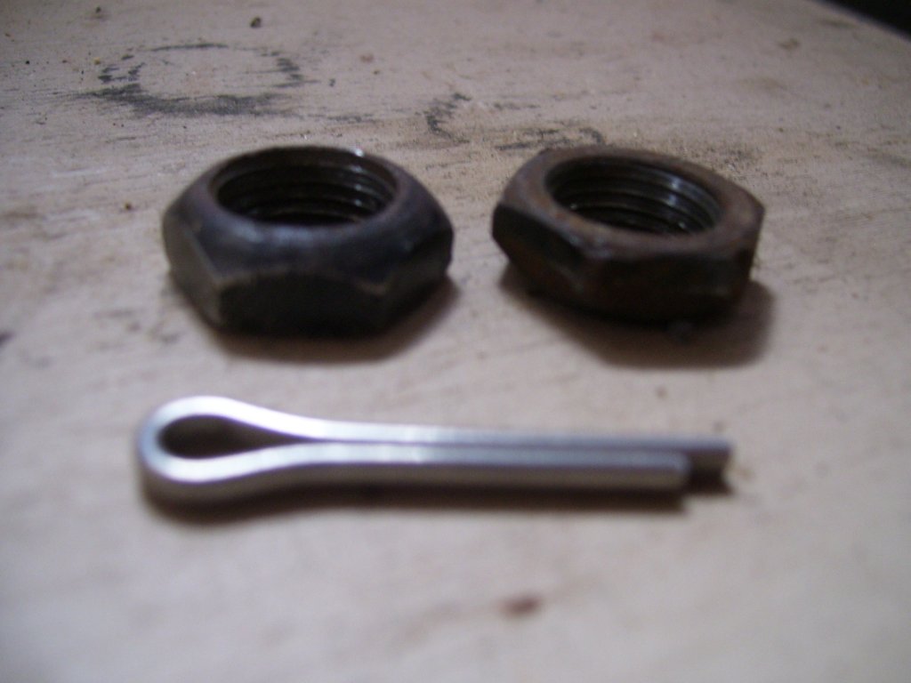

Sorry for the quality, but this is what they look like next to a cotter pin.
You can see they are rounded on one side to fit the carrier.
