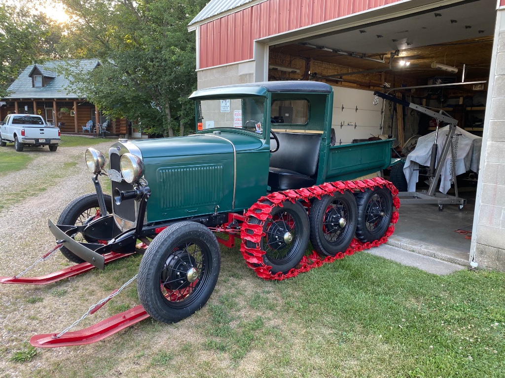

This is a 1931 Model A with a Supersnowbird kit made by ARPS. I chose to paint it red to highlight the parts of the kit. The pickup bed is 26/27 Model T.

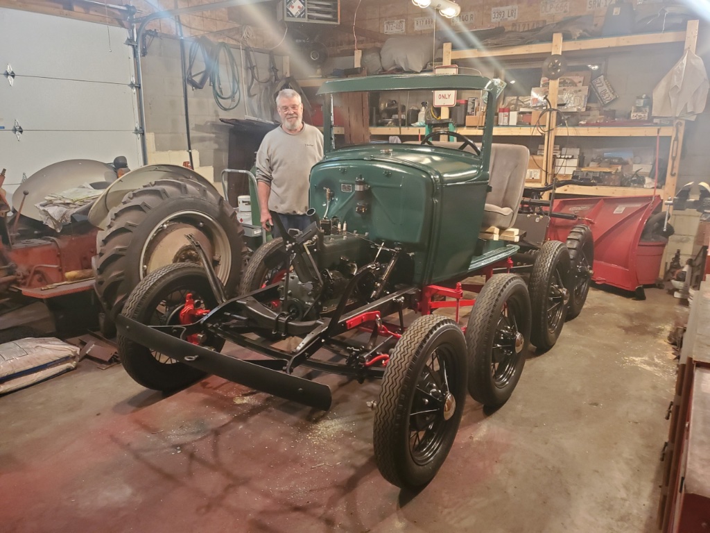

The building process.

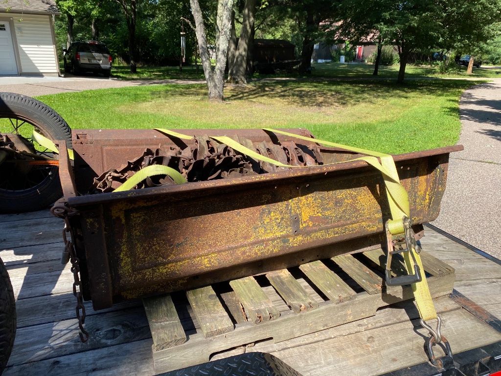

Joe - that appears to be a '25 box - '26-'27 had the fender outline similar to a Model A box.

It could be. It is not Model A. For some reason they bent the Model A frame straight also to accommodate the box. It does use the 26/31 tailgate.
Posts: 5359
Re: Snow Mobile Questions
Post by RajoRacer » Fri Nov 04, 2022 4:33 pm
Yes, same tailgate throughout. The stamping in the middle of the box (notice the 2 rivet holes) are for special, one year only rear fender brackets - that's a rare box as it is a one year only also ! Does the front panel have a "kick-out" for the battery access ?

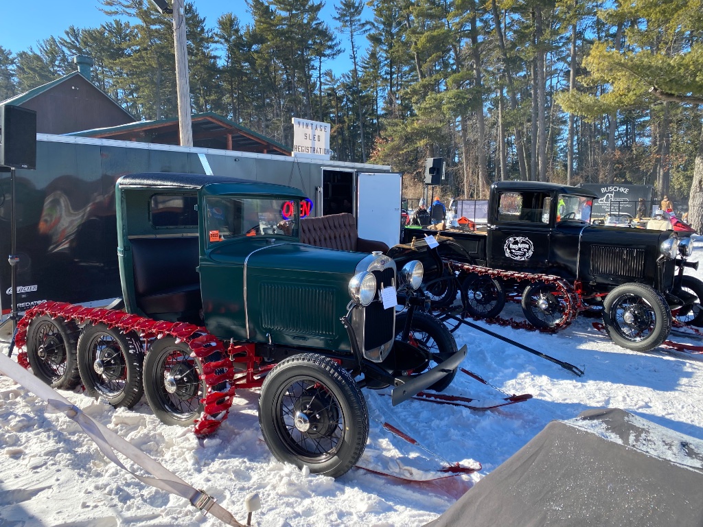

This was last year at the Manawa Snodeo, in Manawa, WI. Two Supersnowbirds.

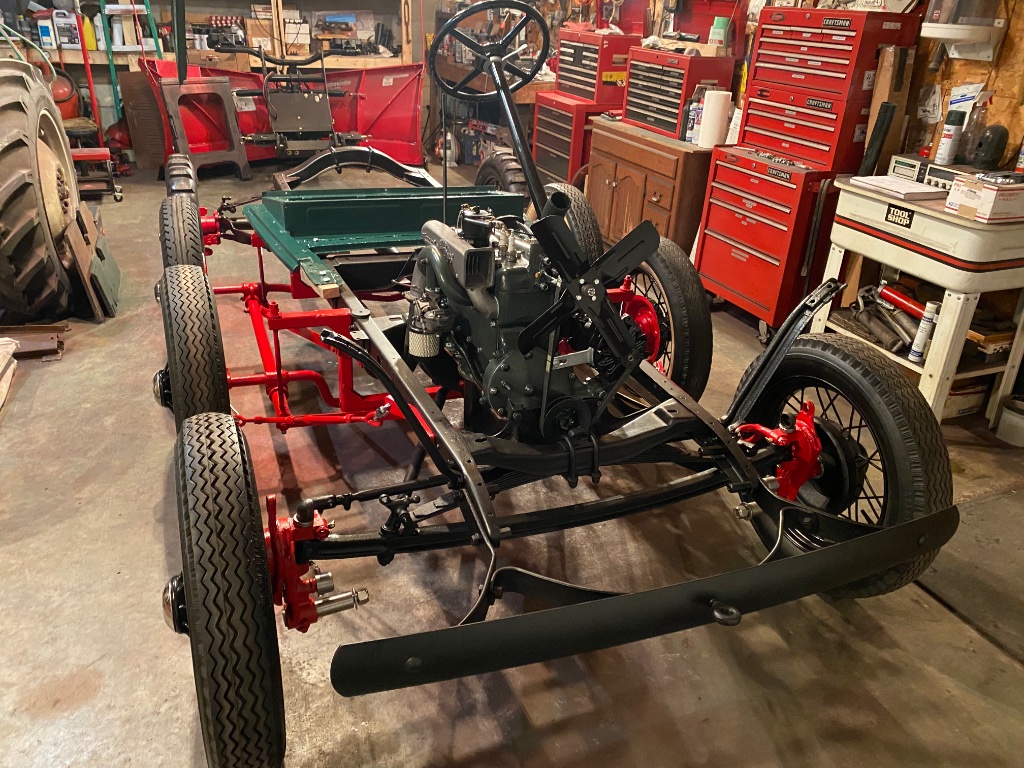

In the midst of biulding one myself
Since high desert and hills or should say mountains here mines based on a TT

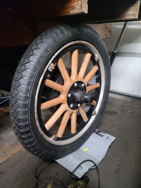

My rear wheels TT hub fitted to 30x3.5 fellow

Looks like a good start. Is your rear axle a standard TT axle?

Bob- Who made your rear wheel wood? They sure did a nice job! Glenn
