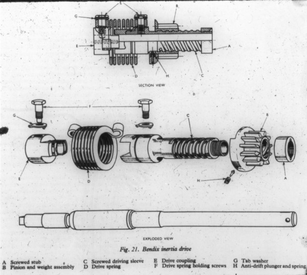

Hello Forum,
I have to get into whatever is under the hogshead for a fact-finding mission. I have read up a little on the topic and had discussions with other T owners. For those who have done it both ways--removing engine or just taking off and replacing hogshead, do you have a preference? I'm into my first year of Model T ownership and although I'm no stranger to mechanical repairs my current record is not so good. I usually break three other things while fixing one issue. I'd like to see more of a 1:1 ratio, which would be a great improvement for me.
Car is a lovely '23 Touring with Z-head and strong motor. Just need to undo some previous snafus.
Thanks very much in advance, and if you have any tips on hogshead R&R I'd greatly appreciate it.
Gerrit
Gerrit

Thank you for the replies.
What’s the issue of your concern? Is the car not driving or shifting correctly, making internal noises or??
What are the snafus that was done previously?
I was afraid you'd ask. On figuring out a starter bendix problem, I believe I dropped some bits and pieces into the transmission. To fish around down there I bought a cheap magnetic flex tool from HF and much to my horror it came back without the magnet. I BELIEVE on that fishing expedition I was in the trans area near the bands, with the inspection cover removed. Or I could have been going through the starter hole as I'd removed the starter.
Now I can turn the motor a little each way by hand before it snags on something--I suspect the "something" is the magnet that came off my tool. That's what I aim to find out. I will remove the starter again and see if I can get a glimpse of anything through the hole.
Since I've gotten very good advice on this forum in the past, feel free to offer more of the same. And I offer my thanks in return and will definitely keep you posted on how it goes.
Gerrit

Does this have anything to do with your questions at the beginning of October regarding the bendix coming off of the starter shaft? Did you ever resolve that issue? If not, it is not something that can be remedied without the removal of the hogshead and, ideally, the transmission from the pan. Attempting to turn the transmission with a bendix in the bottom can do some major damage to the delicate mag coils. Jim Patrick

jiminbartow wrote: ↑Tue Nov 15, 2022 2:58 pmDoes this have anything to do with your questions at the beginning of October regarding the bendix coming off of the starter shaft? Did you ever resolve that issue? If not, it is not something that can be remedied without the removal of the hogshead and, ideally, the transmission from the pan. Attempting to turn the transmission with a bendix in the bottom can do some major damage to the delicate mag coils. Jim Patrick
Yes, it's related to that issue. I have a good understanding now what I'm up against, just a matter of rolling up my sleeves and getting my hands dirty. And stoking the wood stove. It's. getting cold here in Maryland. Thanks for the advice, I'll read any and all replies. Gerrit

There will be several pieces to locate within the gears or magnets of the transmission. 2 bolts (f), 2 tab washers (g), 1 drive spring (d), 1 drive coupling (e) and the spiral gear assembly (a,b,c). Don’t miss anything. Jim Patrick

He Found Part A, as it was loose, but still on the starter shaft.
The rear bolt and washer were still among the missing the last I heard.
That was a month or two ago.
