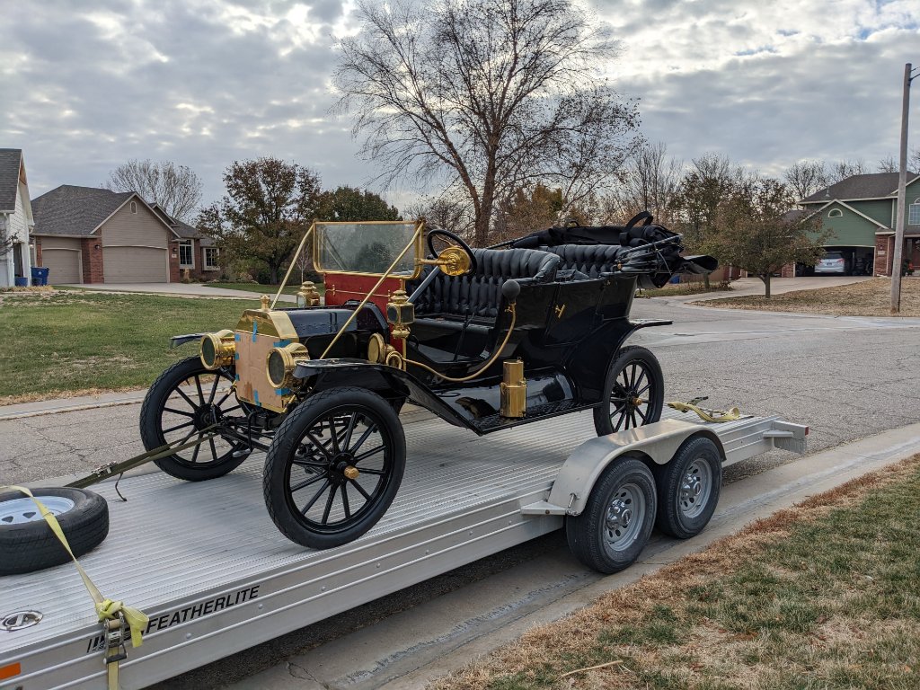

I mentioned when I started this post that I needed to take the 11 back to the vehicle inspection place to prove that it was runnable and drivable so that I could get a highway title for it. A few days ago I posted that the choking technique that makes this T happy is a 1/4 rich and six 1/4 turn choke pulls.
Well this surprisingly long cold spell continues and my friend was coming with his trailer early this morning to take us to the place. I used the same choking procedure that I learned a few days ago and once again I almost got a free start. It started one or two pulls after that. I put a piece of cardboard over the radiator so that it didn't suck out all the heat from the coolant while pulling it for 20 minutes with temps in the 20s. It seemed to help as it easily started when we got there. That place has been increasingly difficult to work with, as I asked if I could just start it on the trailer and show that I could move it back and forth. Nope. It had to come off the trailer, even though prior T's that I brought there didn't have to come off.
Anyway, I got the form that I needed and then went to get my antique license plate and roadworthy title. Unfortunately Kansas didn't have statewide plates in 1911, so I couldn't get an original like I did for our 15. It was amazing how long the lady had to type away to change one box on the title...
Thanks again everyone for your feedback on how to reliably start this T in cold weather.
