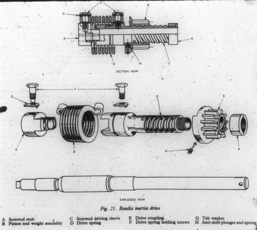

There will be several pieces to locate within the gears or magnets of the transmission. 2 bolts (f), 2 tab washers (g), 1 drive spring (d), 1 drive coupling (e) and the spiral gear assembly (a,b,c). Don’t miss anything. Jim Patrick

He Found Part A, as it was loose, but still on the starter shaft.
The rear bolt and washer were still among the missing the last I heard.
That was a month or two ago.
