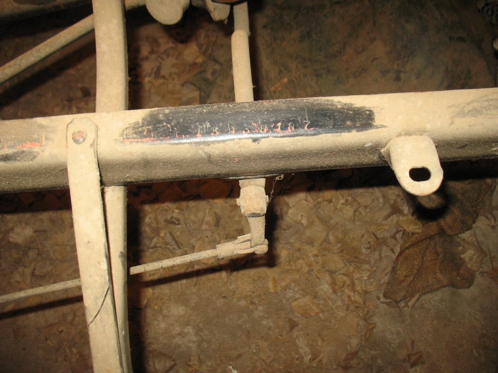

Ford didn't "go back" to putting the engine number on the frame. That was never done before December 12, 1925. Before that date the engine serial number is the only VIN. That doesn't mean that the engine number couldn't have been stamped on the frame by "somebody". The frame location of the serial number is on top of the rail under the floor board, usually the right rail, directly over the hand brake shaft.
If I had been stamping these numbers in the Ford factory I think I would have clamped a ruler on the frame so I'd get the numbers straight.
