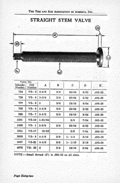

Here is a page from a 1930s Schrader catalog that shows the dimensions of several stems, including 724 and 777.
It says the major thread size for a 724 stem is 0.482-26.
For a 777 stem, it is 0.406-28.
Hope this helps. :)

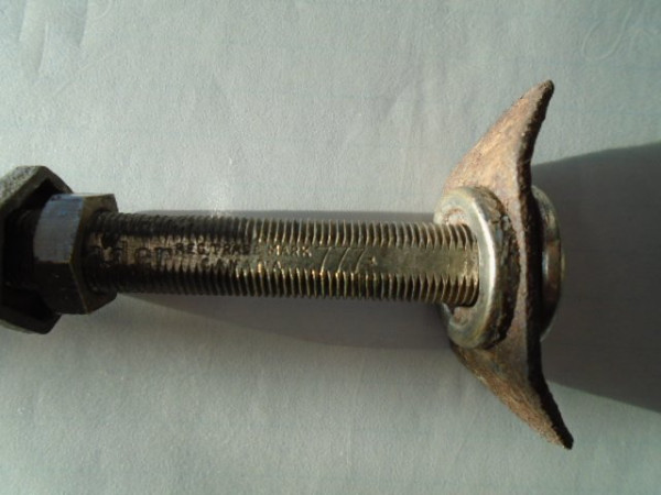

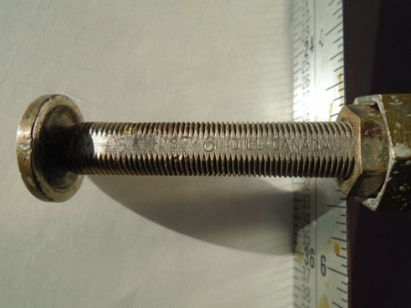

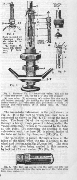

This is an original Ford valve stem.
Posts: 2550
Last Name: Strange
Location: Hillsboro, MO
Re: Valve stem size?

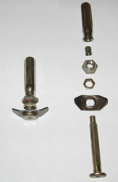

Post by CudaMan » Mon Nov 14, 2022 1:23 pm
With the bridge washer installed upside down. :)

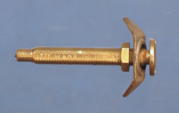

Here are some more Schrader 777 pics.

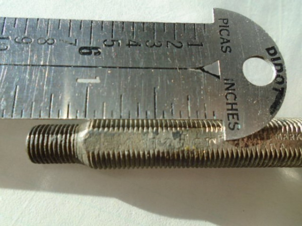

Post by Altair » Mon Nov 14, 2022 9:00 pm
[attachment=1.]
Both stems are from the same maker both have 28tpi

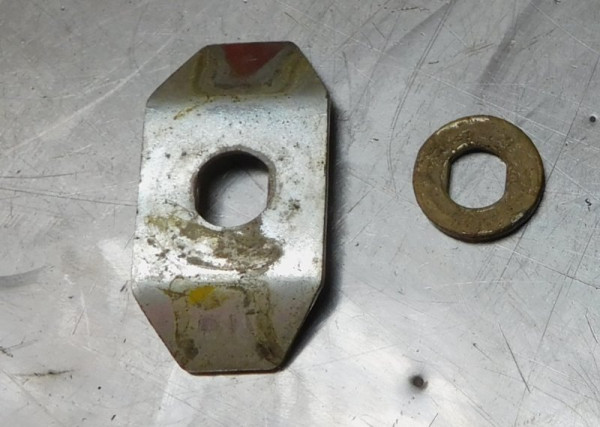

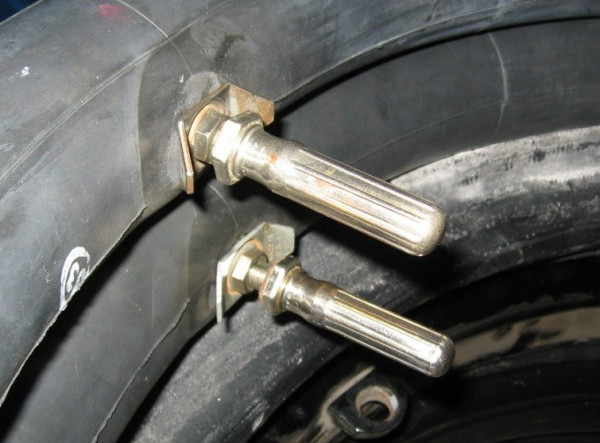

Most of the repro bridge washers I've seen are not made correctly, and my guess if you used one they might be prone to a future leak. Also keep in mind there are two sizes of them.
Posts: 7413
Post by Steve Jelf » Tue Nov 15, 2022 12:56 pm

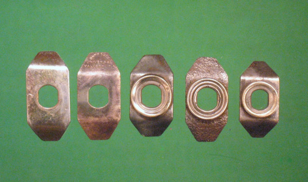

For those who haven't seen it, this picture shows what Larry mentioned.
Most original bridge washers, like the three on the right here, have raised ridges that press into the rubber of the tube to grip it securely and make a good seal. My guess is that the two on the left were made before anybody came up with the ridges. Current reproductions are made without ridges too, because the makers assume they will be used only with modern stems vulcanized into the tubes.

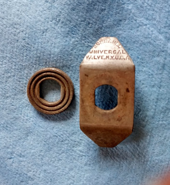

I don't think there was ever a time when "ridges" hadn't been thought of. There are several period suppliers who supplied "the ridges" as a separate and unique part. I have several of such pieces, and they were used with, and without the standard "winged" bridge washer. They are shown in multiple trades magazines and literature.
I cannot recall the source of the below photo, so cannot verify that the bridge washer is vintage or not, but the compression washer is.

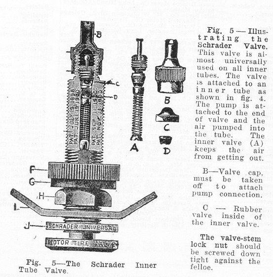

Period picture with the "ridges" on a separate part from the bridge washer:

And now for the actual Schrader Universal hardware (got out to my shop this AM...BRRRR)

In Mark's illustration showing two separate pieces, the latest patent date is 1900. I suspect Schrader made their bridge washers that way first, and later combined them in one piece. I have both types with the Schrader name on them, though most bridge washers of either type are unmarked.

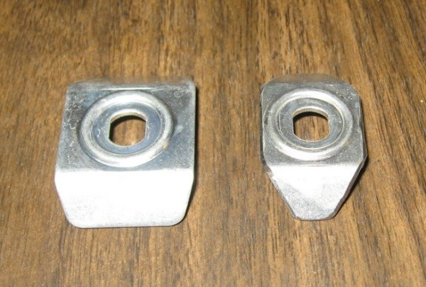

Post by CudaMan » Thu Nov 17, 2022 6:46 pm
By the way, the Model A Ford vendors sell a bridge washer with the proper dimpling to clamp the rubber tube. It is much wider than a typical Model T bridge washer, but can be cut down to the proper size and shape with a cutoff wheel in a dremel tool. Just be sure to deburr all of the cut edges so that they can't cut the tube. :)
