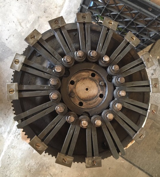

I'm about to install the transmission back on to my temp engine and need some advice on how to proceed.
First...at some point in the past a couple of the magnet clamp screw heads broke off and the clamps came off. What's the best way to remove the remains of the broken clamp screws?
What else should I be looking for as I inspect everything.
A couple things to note:
- I spent a lot of time closely inspecting each magnet with a flashlight and magnifying glass and none of them appear to be broken.
- The rear main bearing was pretty badly worn (I've had it rebabbitte). I'm wondering if that had anything to do with the clamps screws being broken off.

Experience grief now, or grief later. Grief now, for the time it takes you to replace all brass screws while you have the chance and no damage is inflicted on your mag ring. Grief later when the next head comes off an old screw and things go ...BANGBANGBANGBANG. With 2 heads missing it is a near certanty that more will follow.
A prudent man will pull the magnets for inspection and recharge them, too. New aluminum standoffs are really cheap insurance, as well.
Also...try to find 2 original keepers. The repros are soft and flex, making adjustments difficult.

Any advice on how to remove the screws? They're REALLY tight. I can't get them to budge.

I had a screw break last fall. To remove it I drilled into the center of the screw with an 1/8” bit from the bottom to relieve the pressure from peining, then grabbed the shank with vice grips and unscrewed it.

For removing just the damaged screws, I'd file the end of the screw to remove the piened end...if original, they were smacked with a tool that must have looked like a tiny meat tenerizer...it makes a bunch of dimples on the end...then take a small, sharp cold chisle and between the magnets, split the aluminum standoff. You should be able to put a vicegrip on the screw and walk it right out.
If removing all of them, you still need to file the tip ends back to the ring gear. I have a hex bit with the EXACT slot width/thickness and use a Milwaulkee screw gun on them if I need some persuasion. The "ratchet" action usually breaks them loose or takes the heads off. Usually after filing, a regular screwdriver is all you need. Once or twice, I used my hammer-drill on really stubborn one and they came right out. It sounds awfull, but isn't the same as hitting the magnets to level them...the keeper is flexed and the impacts that the screw gets is not transmitted nearly as harshly to the magnets as when hitting them to level them (which I don't do... I shim them UP rather than hammer them DOWN)

I had to actually drill the peined end of the screws when disassembling my magnets. They're brass and it's easy to drill just enough of the end so that the screws will unscrew normally..............but be patient! Since they ARE brass, overzealous use of a screwdriver might break one off. In that case a small drill and Ezy out is called for.

On the broken ones, it may help to turn them in some to help cut off the peined end. I have some keepers if you want them.

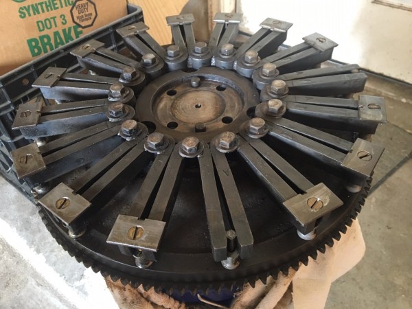

Is it just me? Or do the keepers on the side of the flywheel where the missing screw heads are/were look like they have been making contact with the mag ring? If so, the problem is much more serious than you realize.

The penned ends of the screws can be neatly leveled out with a small sharp cold chisel or you can use a dremal to smooth them out. Once you do that they screw out easily most every time. Now is the time to replace all the screws and be done with it. MUCH easier to do than having to do it after you get the engine running and hearing a click or two later on!

If you don't have them, obtain copies of the books Engine, and Transmission, and Electrical system from the club or one of the vendors. Those books have detailed instructions how to proceed with the work. If you have the original magneto coils I would strongly recommend replacing the ring. The old insulation is almost always ready to disintegrate. The newer rewound ones are insulated with fiberglass tape and dipped in resin and much longer lasting.
Also closely inspect the starter ring. If the teeth are worn it should be replaced. The screws are threaded into the ring and if you replace it, you can also replace all the screws with new ones and you won't need to be concerned about whether you break them getting them out.
Also when you have things apart, check all magnets for cracks and recharge them. Then follow instructions on how to set the magneto ring and magnets for proper clearance all around and you should not have any more problems with the magneto.
While things are apart it would also be a good idea to go through the engine and transmission and adjust or replace everything which is worn.

I agree with Scott about shimming up the low magnets rather than pounding down the high ones.

You're right, though given the ring gear wear and the crystilization on the bolts, I'm betting they are original. It is good of you to mention this to Don so that he is aware that there are two different screws available and that they are not directly interchangeably.
Also, since this is a bargain build, Don, consider rotating your ring gear 90 degrees to place fresh teeth in the path of the starter.
