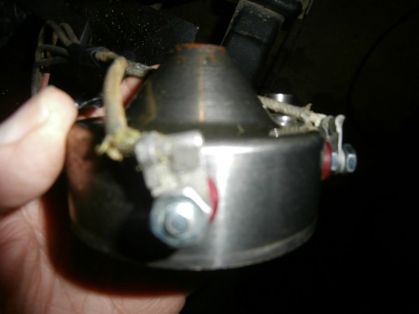

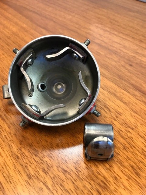

My problem was went I went to start it, it backfired and would not start. To make a long story short, I pulled the commutator and the rotor was all twisted and destroyed. The commutator cap is brand new but the rotor appeared original. So ordered another rotor which I installed and had the same thing happened. Two rotors destroyed. Inside of commutator looks excellent, no damage. Attached is the picture of the cap; is this an Andersen cap and I am putting in the wrong rotor??? The cap has the contact points numbered. Any help on this problem would be greatly appreciated. Thanks! Chuck

Mark: Is this cap from an Anderson timer??
Thanks for your info! Chuck

Post by Mark Gregush » Fri Apr 26, 2019 11:01 pm
looks like it, show the outer side.

Post by Mark Gregush » Sat Apr 27, 2019 12:10 am
Might not be an Anderson, but to be sure show the rotor and other side. I can't think of any way that a rotor could be destroyed by back firing. If it was a standard timer with just contacts inside, the rotor would just roll backwards. If it is indeed an Anderson and you are trying to use a roller type, that would be an issue. You would need the flapper type contact.

You will be surprised how much a new wire harness will improve the operation of the engine. As stated, with that cap U need a flapper, not a rotor. Make sure none of the wires or connectors are grounded because that would give you a backfire.

Closer look...That flapper looks like it has a "wheel". That's a good idea

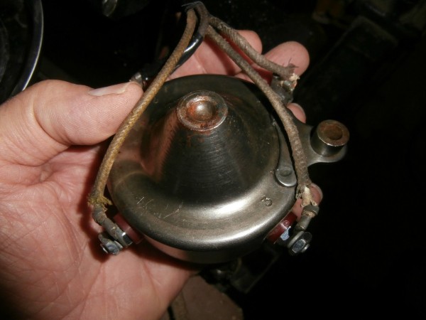

Post by ChuckLebeda » Sat Apr 27, 2019 10:57 am

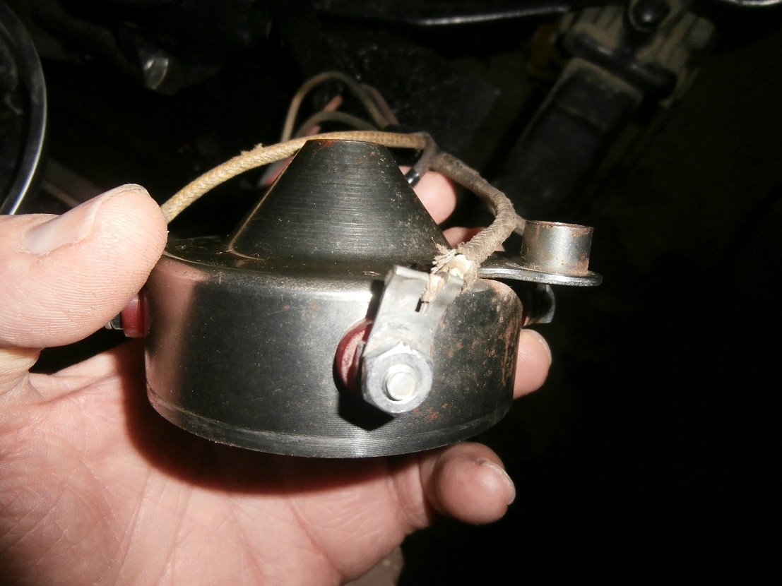

Here is the side view. Needs an ANCO roller/rotor.

Post by Mark Gregush » Sat Apr 27, 2019 11:02 am
That still does not tell us anything. Need to see the insides.

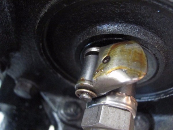

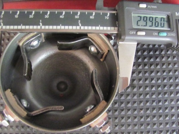

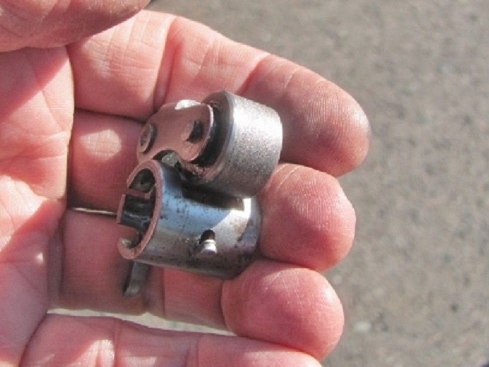

Anderson timer shell has arms inside, the rotor is a flapper, spring loaded.

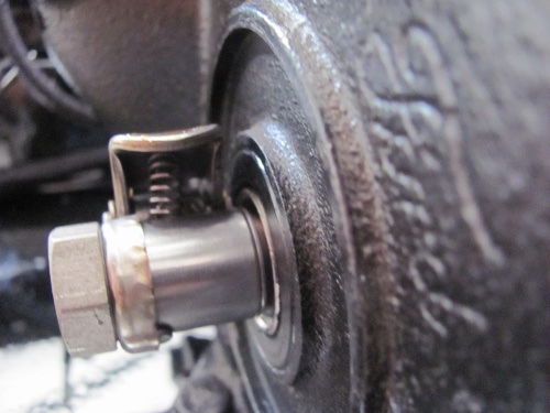

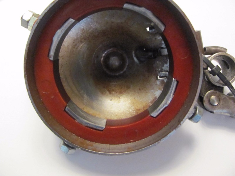

The common Ford style timer case has contacts imbedded in a ring, the rotor is a spring loaded roller.
Mixing the two is problem.

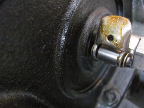

I have used the spacers before. Usually depends on the cam you have, some have shoulders a bit long or short. If too long you can get a rotor with more narrow cylinder. For most times, one or no spacers works. Check the need for spacers by testing the action of the flapper, once you fasten it firmly with the cam shaft nut. Test the flapper so it moves completely free. Any impingement on the front plate will cause the flapper to hang up. Use a spacer to place it away from the front plate.
Normally using the spacers won't interfere with the rotor pin, but....at times had to rat tail file the slot a tiny bit for the pin to fit in snug. The Anderson pin cap is unique, has a good raised edge to clear and retain the pin, and has a cutaway for the flapper action, (i.e. the flapper circle clip and axle) ; if you use a Ford std. pin cap without that cutaway, you can have the flapper hang open or closed. :|
Bit of high strength grease on the flapper, for lube against the case fingers. This view shows the raised edge over the rotor pin, and the cutaway edge, you can see the flapper axle is free to move, no pinching.
