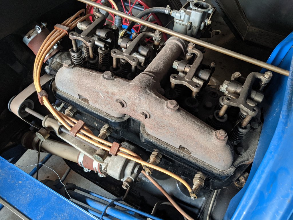

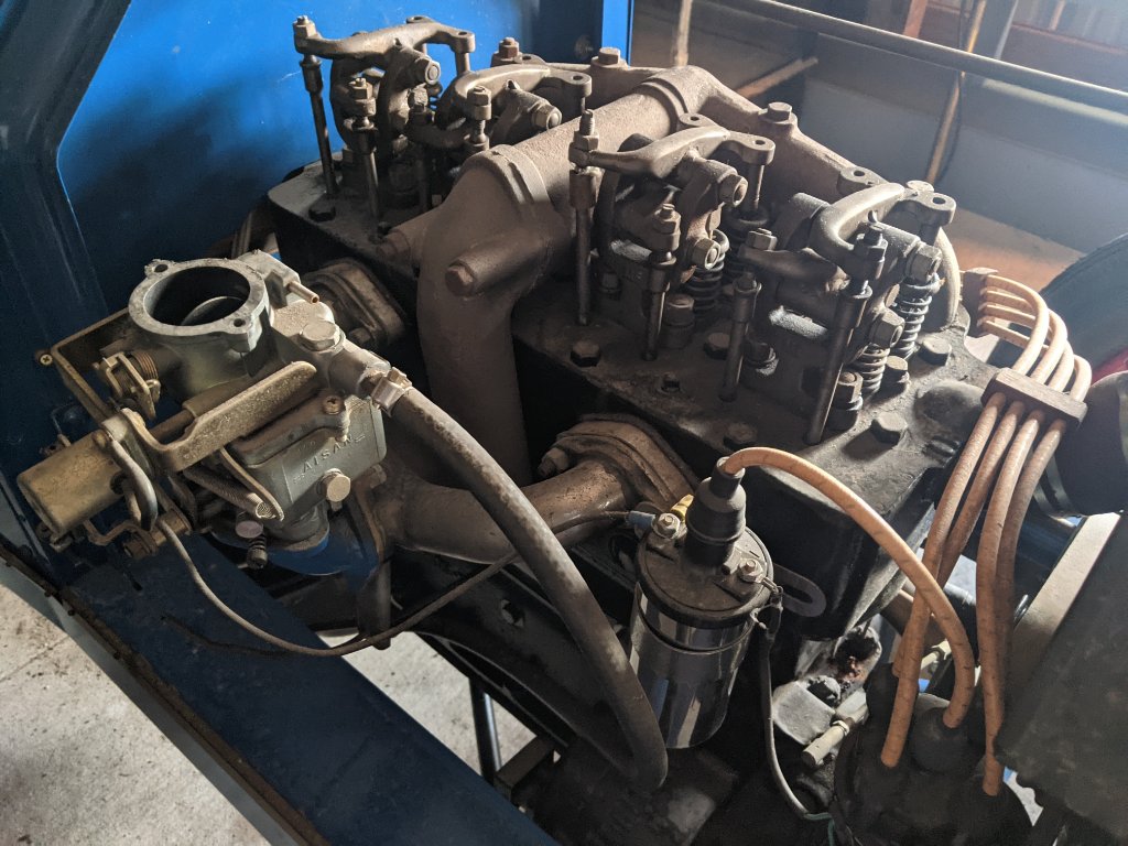

Lubrication was like that for most if not all of the overheads built for a T. The felt pad has worked fine for me on both a 4 valve Rajo and a Fronty. It is nice to have a valve cover for those of us who mainly use them for touring. The early racers may not have been as concerned about keeping out the dust, rocks and birds.

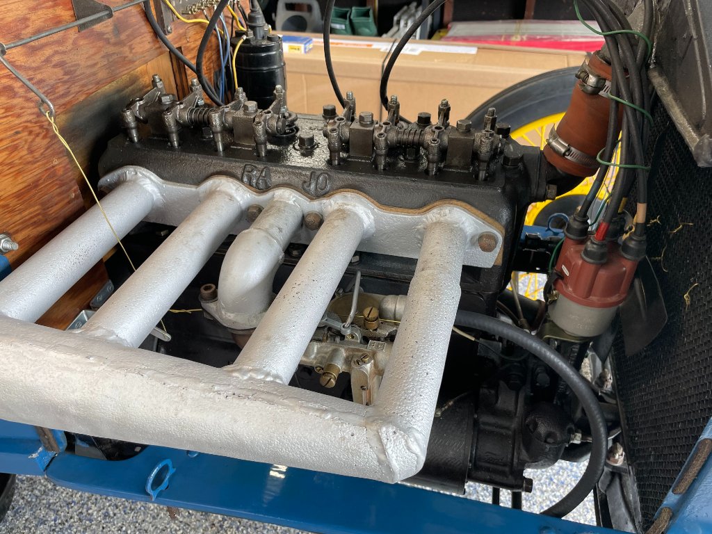

My Rajo Model 30 did not come with valve rocker covers, at least according to the literature I've seen. Like Steve, I always oil it up pretty well before I fire it up. The attached PDF has some details about the various overheads that were made for Model Ts.
