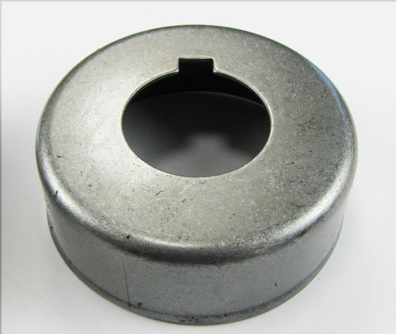

Apparently, few have installed those retainer caps. They go on just fine with the key in place.
Topic author - Posts: 7411
Re: Why a notch?
Clearing the key was the only reason that occurred to me. So if that's the case there are two possible procedures that require the notch:
1 Install the washer, which has no notch, then the felt, which has no notch, then the key, and finally the cap, using the notch to get it past the key.
2 Remove the cap, using the notch to get it past the key, then remove the key, and then the felt, and then the washer.
How are those procedures better than installing or removing all three parts without the key in place?

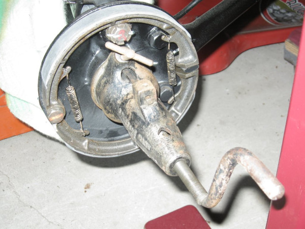

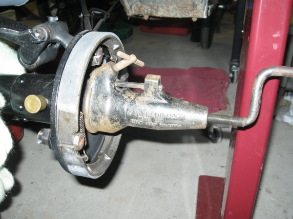

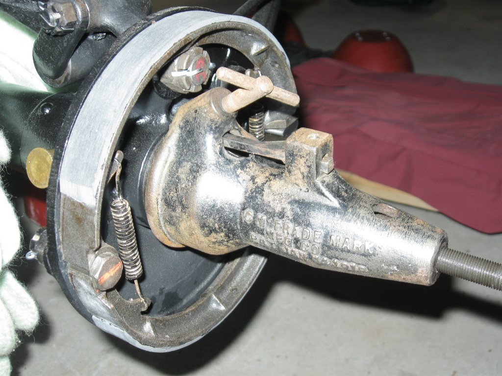

I used to agree with that statement, then I found the right tool for the job:

Re: Why a notch?
Well La Dee Da Now I have a new tool to look for. Thanks Pep
RVA23T
- Posts: 851
- Last Name: C
Re: Why a notch?
It would be great to see the inside of the tool when possible.
