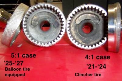

Tom, there are several versions of pitman arms, so to say yours is like everyone else's, is probably due to small sample size. If you truely have 4:1 steering, you have the shorter "arc" safety groove in your gear case, then the limiting factor in your turning would be a too-short pitman arm.
On the other hand if you really have 5:1 gears in the thing because it was "improved" by someone (and you don't realize it), you will be limited by the shorter groove in the older gearcase. This is something missed by EVERYONE who updates their steering from 4:1 to 5:1.
Here's an example of the two different gearboxes...
late and early case with groove .jpg (27.56 KiB) Viewed 2494 times
photo courtesy of Dan Treace.

you are welcome. It's a distinction lost on many if not most people. I myself have forgotten to mention is in the past on several occasions in which it may have been pertinent. Maybe this will keep my memory jogged. Dan Treace was kind enough to provide photo-documentation of this some time back and I have found it useful more than once.

I have been aware of the difference in the length of the groove for a long time, although it wasn't until about two decades ago that I found which way it was connected to the gear ratio. And, certainly, the shorter groove can and likely will limit the turning radius somewhat. Maybe. What reason the 5/1 has the long groove and the 4/1 has the short groove? I don't know. It does help in identifying the gearcase for better fitting of proper gears. The outer gear cuts are slightly different, and although either 5/1 or 4/1 can work in either case, they do work better if properly matched.
I would recommend checking to see which case and gears you have! Mostly just to know what you are dealing with.
HOWEVER! Irrespective and regardless! And while there MAY be some minor limitation added by the shorter groove? The gear ratio DOES NOT have an effect on the limitation of travel! That limitation of travel is FIXED to the steering main shaft! The only thing that the gear ratio does is change the number of degrees the steering wheel has to be turned between the limits. The pitman arm in turn is FIXED to the main steering shaft, so its limitation is also unchanged by the gear ratio. Again, plain and simple, the only thing the gear ratio difference will change will be the number of degrees rotation needed between whatever limits are placed by other steering components, and in turn the leverage advantages and again in turn to some degree the amount of control (faster versus slower response).

And by the way? That small amount of larger groove way out on the end of about a 160 degree arc? It is like a bell curve on a graph. A few degrees near the middle makes a big difference. The same number of degrees out on the ends make almost no difference. Three dimensional geometry.

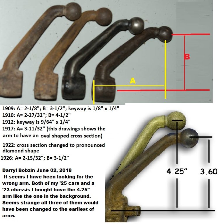

Yes, it is fixed. The pitman arm during that era is also modestly shorter as well. The greater rotational input allowed by the later gearbox allows it to swing a greater arc and with the shorter length, higher gear ratio, and a much larger steering wheel, steering ease is enhanced. Leverage; No mystery.

as far as the machined arc is concerned, Mark Nunn provided the following information in an old post (thank you Mark)
02-23-22 Changed angle between centerline of case and the center of 13/64” radius at ends of slot for stop pin from 45 degrees to 51 degrees.
05-27-24 Changed angle between centerline and ends of stop slot from 51 degrees to 60 degrees.
09-27-24 Changed angle between centerline and right hand end of slot from 60 degrees to 65 degrees. Specified for 1925.
10-07-25 Changed angle between centerline and ends of stop slot from 60 to 62 degrees on left side and 55 to 67 degrees on right side

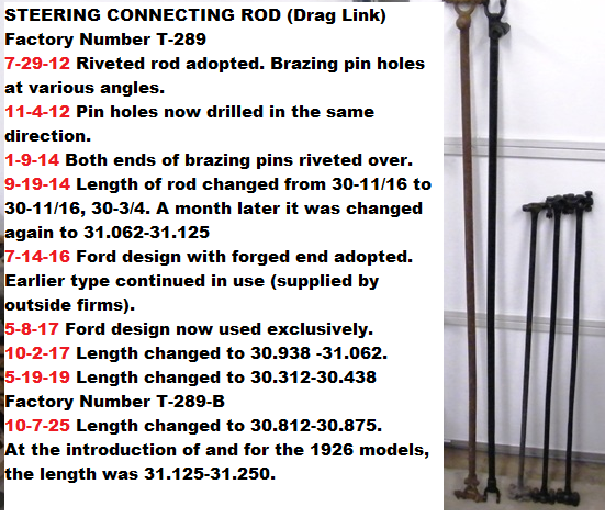

I'm not going to do the research, but I'll bet that drag link lengths were changed within days at the same time (there were several versions/lengths of drag links, having gone through several iterations over the years) to account for varying pitman arm length and increased/decreased/biased rotational input at the steering wheel.

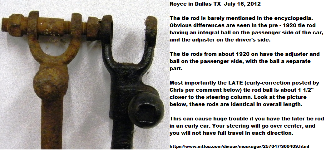

Since the issue existed at the time you purchased the car perhaps some of he steering components were changed. Also if other members in the club don't have the issue then I would compare your components having the same Model Year as you have. You did say that the pit man arm was the same as other's but what are the dimensions? As you know previous owners may have replaced things over the years
Still wondering if your drag link or tie rod are hitting something to cause a stop.
Drag link.png (162.23 KiB) Viewed 2257 times
Posts: 4683

It’s interesting about the pitman arms. The suppliers sell arm # 3547 which according to them fits 09-27. Are they aware there some year differences? Or is the difference not enough to cause any issues? But for some it can be? Maybe some of the tie rods were changed?
https://www.modeltford.com/item/3547.aspx
