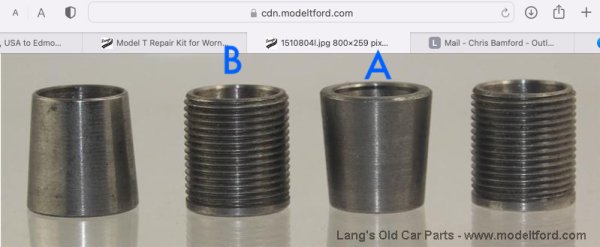

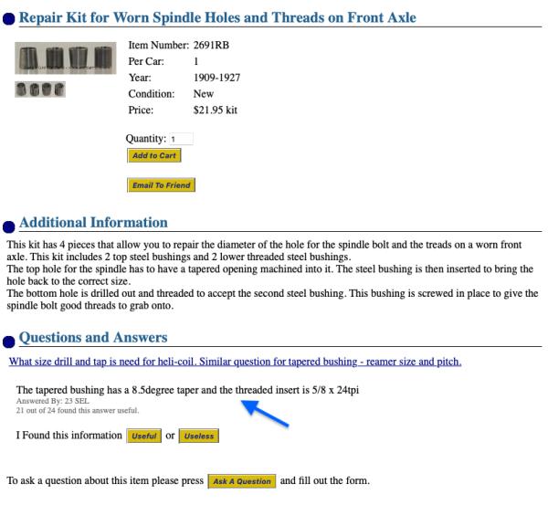

Lang's markets front axle repair kits with a tapered upper insert. They state an 8-1/2° taper reamer is required.
Internet searches for these reamers have come up dry (and/or I'm not searching right).
Where is such a tool generally available? Thank you.

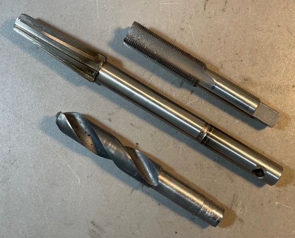

My reamers are copies of the Stevens reamers. But I make mine 1/4” longer on the big end so they can be sharpened. If anyone wants a copy of the original Stevens instructions that they sent with the tool, email me.
I may have an original Stevens reamer I will sell. Email me if you are interested. Dan
As an added note my reamer can be sharpened by any tool sharpening company that sharpens end mills.

Years ago before Dan Hatch was making reproduction reamers for the Stevens Axle Bushing Jig, I made my own. For the top bushing reamer, I started with an automotive ball joint reamer and cut the length of the fluted down so it would fit in the frame. The ball joint reamer cuts the hole to a 1-1/2” per foot taper or about a 7 degree angle. I had to make my own top bushings with the 7 degree angle, which was OK because top bushings and bottom inserts were not available then either.
For the lower threaded bushing I started with a stub length 9/16” drill and turned the shank down to 1/2” so it would fit in the Stevens frame. This forms the pilot hole for a 5/8”x24 tap which came with a 1/2” diameter shank so it fit the Stevens frame. The inserts were, like the top bushings, made on my South Bend 9 lathe. They were threaded 5/8-24 on the outside and standard 1/2x20 on the inside. The top of the insert has to be relieved a bit to allow the spindle bolt to enter it.
These tools worked pretty well for me, and they were used to save a couple of scarce early front axles. Later on I bought a set of Dan’s reproduction reamers, probably from Lang’s, and have used them and the new top and bottom bushings since.
