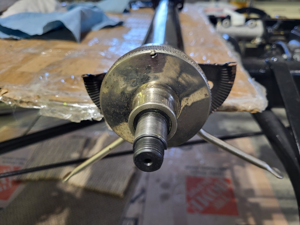

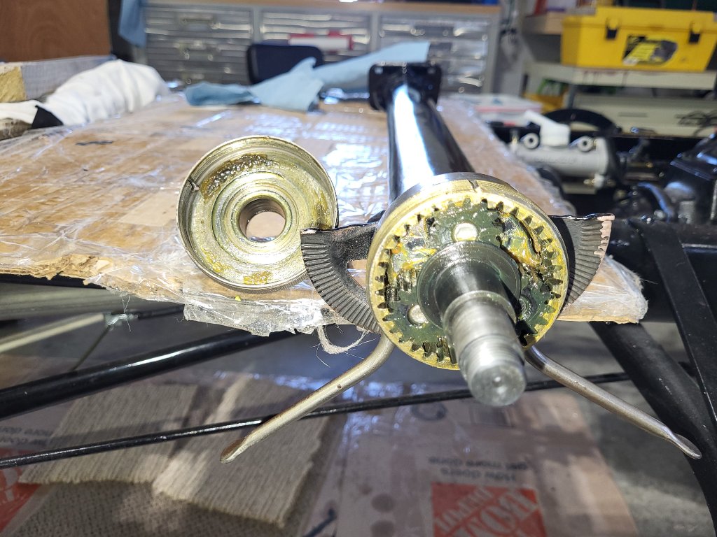

I just installed a new steering shaft and gears for my 1927 coupe, and now I have question.
Right after I finished the install, I reread the steering shaft replacement section in the Ford Service Manual. I noticed that I had forgotten that it says the steering case should be "filled" with wheel grease. I didn't do that. I greased the various components and added extra grease at several locations.
My question is: Should I take the case cover off and pack the interior full of grease?

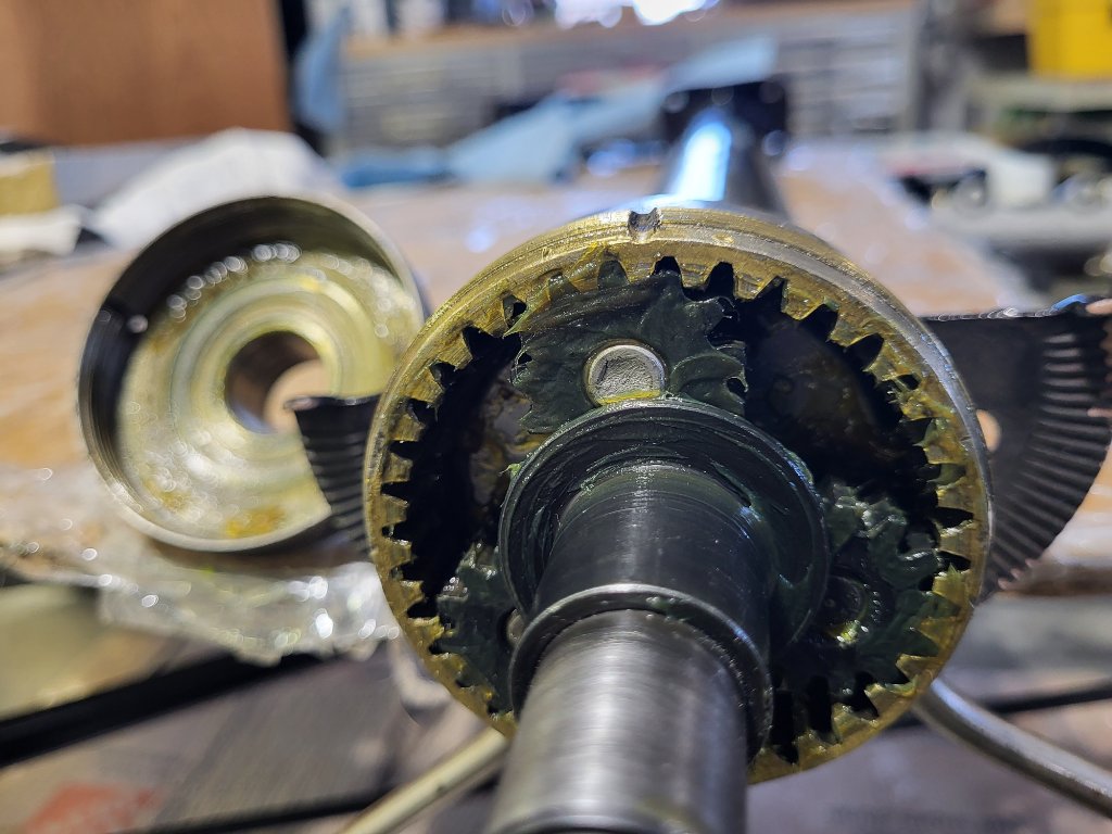

Judging from the pictures that you posted of the steering before the cover was put on the amount of grease shown looks to be a little too light. Some more grease would be better as long as you don’t pack it full. If on long drives the gear case gets warm to the touch, then definitely to little grease.
