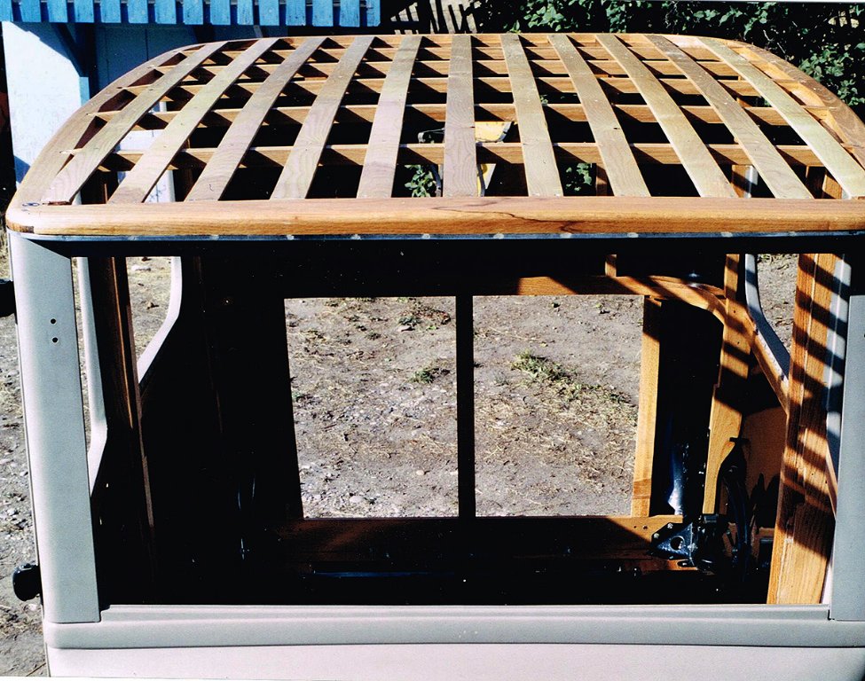

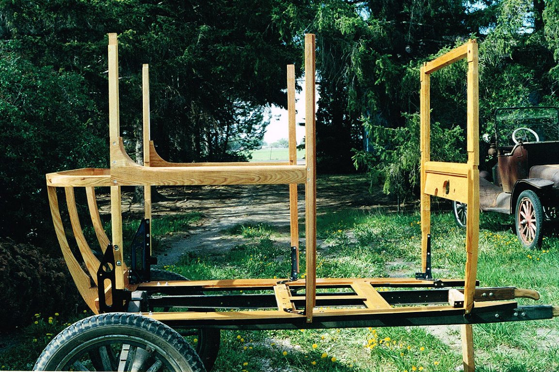

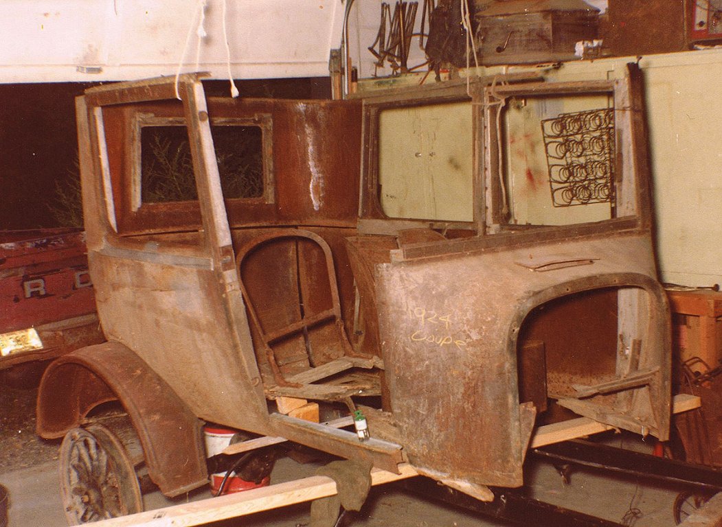

I ran across this photo today. It was taken in 1979 while mocking up the pieces of my 24-25 Tudor. I had forgotten the excitement of the prospect of having a closed car after a dozen years of open Ts. We were expecting and thought a Sedan would be better for the baby to ride in. However, he was graduating from High Scholl before we got the Tudor on the road. We have enjoyed the car since then and our Grandchildren benefit from the shelter.
It was before wood kits were available and the bottom 4" of wood was missing or badly rotted. Pictures from the Body book and what remained from 3 Tudors helped the puzzle along. Choices of sheet metal varied from rusted out to badly bent up. (Oh, and bullet holes too) I searched for one door for years. I had two for the other side. We take the car for granted now but I always have enjoy seeing better ones for sale since.

Rich, you do really nice work!!! Your paintings are amazing & often hard to tell that they're not photo's. These pictures of your '24 show that you do really good wood work also.

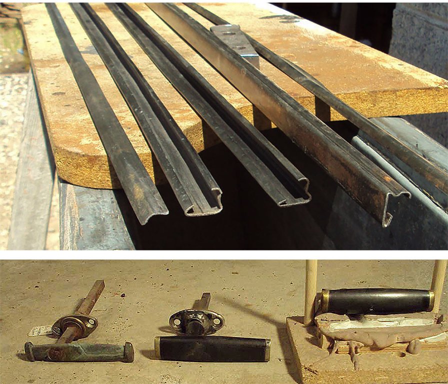

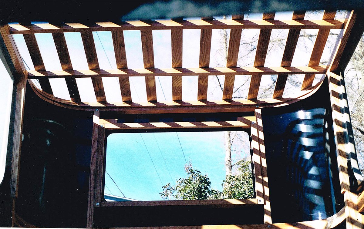

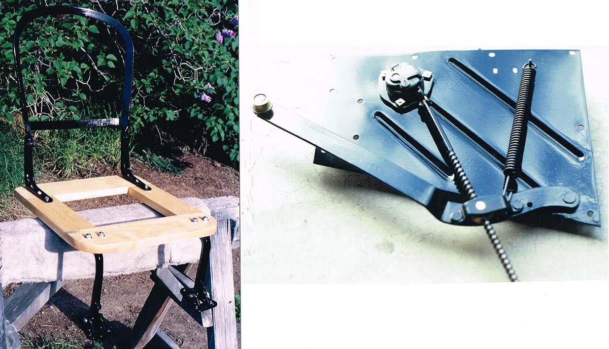

The passenger seat is unusual in that it cantilevers without any support at the rear. I worried than it might be weak as I found a couple broken frames. However, we have load tested it several times and it is plenty strong. The window mechanisms are odd and hard to find parts for, but I was able to make them functional. I wanted authentic rain gutters, so I tooled up and made some.
download/file.php?id=11899&mode=view
Also, the Bakelite was cracked on the outside door handles. I had the ends plated and then used good old Bondo painted black.

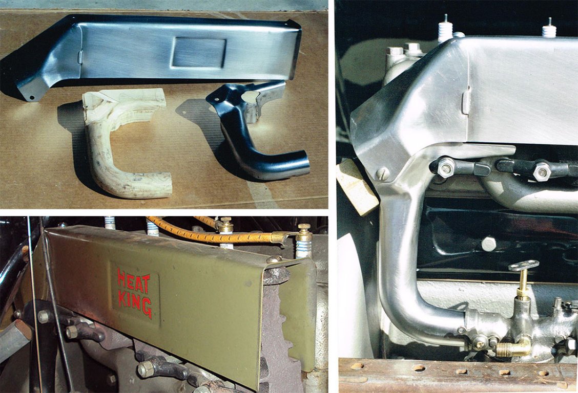

download/file.php?id=3956&mode=view It's held up well for 20 some years. I was fortunate to find a heater manifold, so I made a new shroud. I also had to make a suitable hot air pipe to go with it.

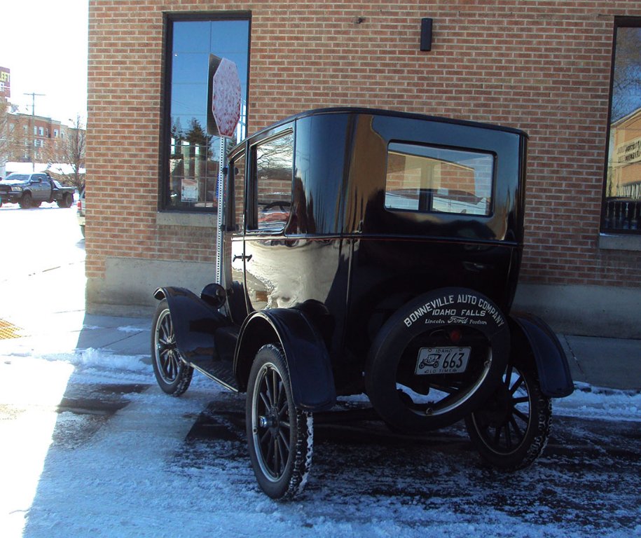

Speaking of the Tudor, we have been driving an old car to our car club dinner banquet for 50 some years now. It used to be popular to take an old car out for it but this year we were the only ones to bring an oldie. It's kind of sad.
Cars 25 years old are eligible yet they did not show up. Still, it was fun to see everyone and share in the Christmas Fun.

Austin, I was using oak for the wood in bodies at that time because I could get it in thicker sizes. I have since been convinced ash is a better choice and glue up 4 quarter pieces to the correct thickness. I have seen no problems with the oak and recall one model T wood kit supplier advertising their kits were oak in the '70s. I like ash and poplar and it is a bit less expensive. I rewooded my '22 Coupe using Douglas fir 2 x 4s. It was easy to work but does not hold nails and screws as well and has split and rotted a bit over the 10 years it has lived outside.
I would not use light primer again as any scratches show up more. However, they are easy to tell where they are for touching up.
