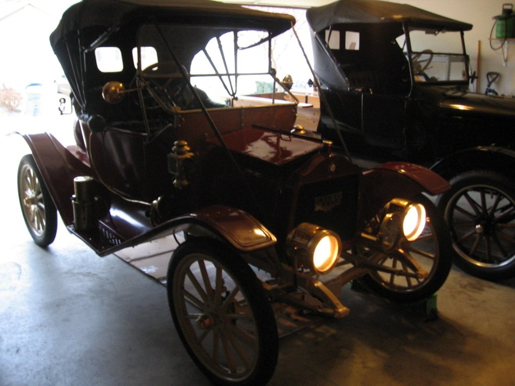

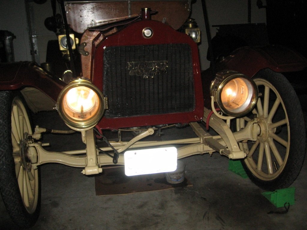

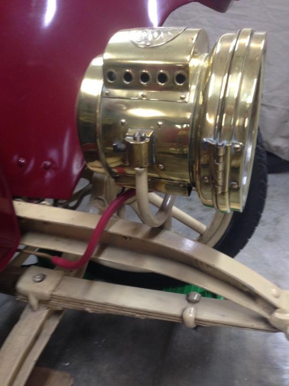

I bought the brass tubing and red gas hose for my 1912 Flanders 20 from McMaster Carr. I couldn't find a one piece brass tee that would fit the tubing, so I ended up using a brass water plumbing tee with compression fittings. It doesn't look correct, but it works. I used my brake flare tool to bulge the tubing on the ends to help hold the hose. Some people solder a compression fitting onto the end of the tubing to make the bulge, it works just as well.
The vendors offer brass clamps for the hose ends and I bought some, but I haven't installed them. I'm pretty sure Ford didn't use clamps. Larry Smith will correct me if I'm mistaken.
