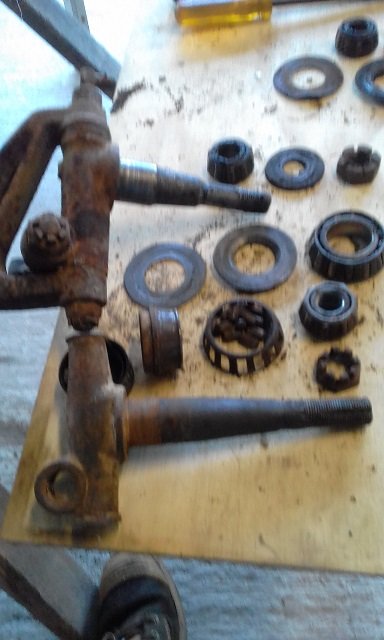

Good morning can anyone tell me the what front spindles I have in the attached image the bottom one measures 155mm overall inside bearing to end of the thread 30mm inside diameter of inside bearing with a thread 50mm long and 19mm diameter the spindle attached to the body of the axle measures 127mm in length 34mm inside bearing and 27mm of thread.
Any help greatly appreciated.

Look like early chevrolet, but I am not an expert on spindles. I know Chevrolet spindles have been used on speedsters because of the drop they provide.

I should say, the top looks like chevrolet. The bottom is model T.

Thanks Chris I thought it was not original.
