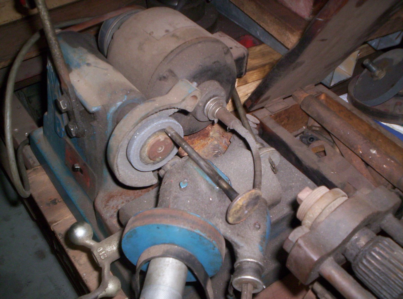

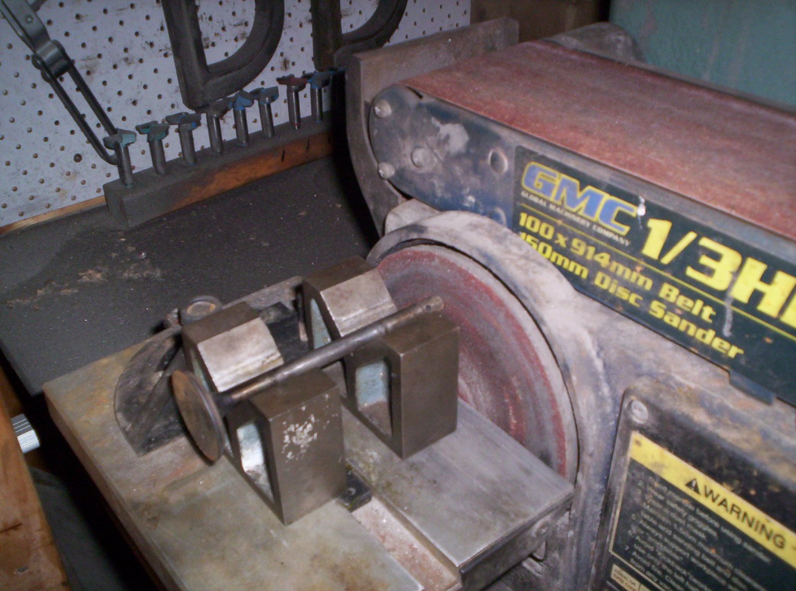

To elaborate some on scott's post, 2 ways to shorten valve stem.
Also when you are looking for your TDC on #4, the valves on #1 would be rocking, in other words both valves would be opening or shutting when turning the piston off TDC back and forth 1/2" or so.[image][/image]
