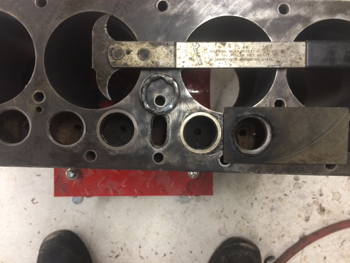

Weld them out

Why are you removing them, Dean? Did someone not install them correctly?

Re: Weld them out
Two had been replaced but were too eroded to resurface. I will install replacement Nickel Chrome seats in all of them so they are uniform.
