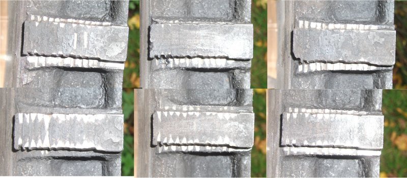

I hate finding things in a engine especially when I can't figure out what the heck it is. Anyone have a idea?

It looks like maybe one of those removable clutch shoes. Its not uncommon. There was a bunch sold aftermarket that crack, break & make their way out. I bough one T that had this issue.
- Posts: 4454
Re: Found in screen magnet
Turn it on its edge. Let's see how thick and how flat it is.

Sorry Guy's I should have given more info to start. I'm real busy getting ready for a school presentation in the morning. I hate loading
in the dark. This was found in my 22 speedster. The trans is made up of pre 24 part's, No clutch lug shoes, No Mag, slingers are made
of aluminum the piece is.037 thick,.87 long, .247 wide. It's steel with a dark color where not worn. The unbroken edge is straight &
it is flat. No curve or radios anywhere. That eliminates a piece of clutch disc, trans thrust washer, piece of band. It is to thick to be
part of the oil funnel. The car has over 700 miles of rode hard & put away wet, No joke the last 30+ miles where in the pouring rain.
on this oil change, no issues at all. I can not rap my mind around what this could be. I deeply appreciate any thoughts you guys have.
If it had lug shoes I would know that I had to pull the engine to make repairs. So I'm at a quandary as to what to do. Any thoughts
are welcome.
Craig.

AZTerry
- Posts: 106
- Joined: Wed Jan 16, 2019 11:18 pm
- First Name: Terry
- Last Name: Loftus
- * REQUIRED* Type and Year of Model Ts owned: 26 Speedster
- Location: Phoenix, AZ
Hello Craig,
Maybe Cody threw it in your engine after you scared the living daylights out of him on the San Diego speedster run.
I couldn't resist the comment.
Now for real, how about the corner off of a six sided clutch disc.
Terry

Terry I will compare it to a clutch disc tomorrow after the school presentation. That could be it. Has anyone seen a 3329 clutch disc,
large, fracture like that? That would be a shame that's the first time I put a stock clutch back in a T trans. I don't think Cody would do
that But then maybe I shouldn't have dirt tracked the the speedster around that one corner. Some people don't think the rear wheels
should lead the fronts around a corner especially on asphalt.
Craig.
Craig.

I think I'd be curious enough to measure the thickness of a transmission band to see if it matches up. I know you kinda' ruled that out, but I dunno'

It does look like a piece of outer clutch disk.Craig Leach wrote: ↑Thu Dec 15, 2022 12:55 amTerry I will compare it to a clutch disc tomorrow after the school presentation. That could be it. Has anyone seen a 3329 clutch disc,
Craig.
I have never seen a piece of disk broke off. I have seen a few cracked thru in one spot.

I was wondering how it could be a piece of clutch disc, but I can see it now. Yes, I believe you're correct!speedytinc wrote: ↑Thu Dec 15, 2022 12:15 pmIt does look like a piece of outer clutch disk.Craig Leach wrote: ↑Thu Dec 15, 2022 12:55 amTerry I will compare it to a clutch disc tomorrow after the school presentation. That could be it. Has anyone seen a 3329 clutch disc,
Craig.

Ding Ding Ding We have some winners, after Terry posted last night I had to go get a disc to compare. SCMTC had a school presentation
this morning so I didn't have time to post this morning. It sure looks like it came off a clutch disc. I also have seen cracked ones but
never like this. Defiantly constitutes the removal of the engine. dadburnit cheese&crackers got allmuddy!#*%$#! Craig.

Ok been busy with other cars and just got back to the found in screen issue. So I pulled the engine, hogshead & pan. found another
broken piece in the front of the pan
that means it made it from the clutch all the way to the front of the engine. Disassembled
the clutch and found 4 cracked large plates. I have never seen this before, anyone else found this and figured out what causes it?
These is the ( best as I can tell) original clutch to this engine. I ran this clutch for over 7 years in this engine and found no issue so
I put it back in. It was dark colored before but smooth & flat. It worked good before and was working fine even after it started
shedding pieces?
Craig.

I haven't taken apart dozens of clutches, but I've done maybe a dozen and I haven't seen anything like this. I'll be interested to see what the more experienced folks have to say about it.

Now when it's a Speedster, I wonder how you change gear to high. Personally I try to do it slow and gentle, rest a little while while in neutral allowing the engine revs to settle down before releasing the pedal in high. I have however seen people just releasing the pedal quick and leaving it to the rather forgiven original clutch design to take care of the difference in speed of engine and transmission. I could suspect that a Speedster could make one do switch like that for quick acceleration.
All my clutches have been "upgraded" to modern type with the clear neutral when possible, but also with the nonforgiven switch which of course is why my driving style have turned into what is described above. My 14 Touring still have the original clutch and I drive that the same way.
That said, the clutch should be able to handle however we may see just an example of fatigue. After all it is 100 years old and may have been driven all 100 years.

I have seen a disk or 2 cracked in a clutch pack, but never chunks off disks.
Are these disks from a non shoed drum?
The disks hanging up in nasty notches worn into the drum lugs I suspect.

I have a half bucket full of clutch discs I’ve saved from transmission tare downs over the years and found a few cracked discs that I’ve thrown away but never any small pieces or chunks of discs. I’ve saved the good discs.
- Posts: 4454
I have the same questions/suspicions that Michael has. Also, wondering how good your clutch spring is. Looks like a lot of slippage and heat has been going on.dykker5502 wrote: ↑Thu Jan 12, 2023 8:18 am... I wonder how you change gear to high. Personally I try to do it slow and gentle, rest a little while in neutral allowing the engine revs to settle down before releasing the pedal in high. I have however seen people just releasing the pedal quick and leaving it to the rather forgiven original clutch design to take care of the difference in speed of engine and transmission. I could suspect that a Speedster could make one do switch like that for quick acceleration.
- Posts: 8626
Jerky shifts, lugging the engine, and worn parts could all contribute to cracks at that location. Running a worn Ujoint probably would, too.

Hi Guys,
This car has a Ruckstell with a 3:1 ring & pinion. The engine is stock inside with a Model A carb. & a header. I have a foot throttle to
make shifting easier so shifts are smooth. The brake drum was used when I installed it and I filed the lugs to remove any grooves.
I installed a new spring when the engine was assembled. I even had someone that I value their 0ppinion look at the clutch before
installing. He did point out that I filed the lugs and asked how I measured the amount of material that was removed? To be honest I
didn't I filed them until they where smooth. This may have been the jink in the armor. If the plate is not equally driving the drum then
there will be excessive load on the ones that do make contact. I'm not sure what I will do to correct it as I got many years of service
before it failed. I don't really want to scrap it & start over.
Craig.

- Posts: 8626
Lugging the engine will jackhammer the discs, especially if the fit is loose or uneven on the lugs. Running with timing over-advanced could do likewise, as could running with a sloppy u-joint or a dry u-joint.
- Posts: 5245
I could be wrong, but I think the groves are not from hammering, at least not exclusively, but from drive pressure.
I believe that during forward running, the natural fluid friction & a bit of disk friction, the disks will all rest touching the contact point of the lugs. They wont float around willie-nillie.
As you increase the load, (acceleration, weight, hill climbing) the more press into the lugs.
Forward movement comes thru the transmission shaft to clutch hub pushing the clutch disks into the lugs as they drive the brake drum & attached output shaft. Those large clutch disk edges take all the power to move the car. Of course the clutch hubs inner disks do also.
- Posts: 4454
I think it's a combination John.speedytinc wrote: ↑Fri Jan 13, 2023 2:07 pmI could be wrong, but I think the groves are not from hammering, at least not exclusively, but from drive pressure.
- Posts: 6786
As for thinking that lugs see even wear, I think Colin Watt's pictures put that idea to rest:
If not convinced, then here is a picture of damage posted by Steve Tomaso:
