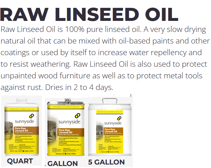

Pure raw linseed oil is almost impossible ro find these days. It is a "drying oil", that is, it forms an irreversible polymer film when it combines with ambient oxygen in the air. It has been the basis of paints for all applications since classical times, and probably long before. For hundreds of years, it has been "cooked" with various resins, metal salts and other amendments to produce paints and varnishes of specific qualities. It is edible and until recently, in common use as a livestock medication. It's the same thing as "flaxseed oil" touted in health food stores.
Common hardware store "boiled linseed oil" is more properly "blown" oil. It is not actually boiled. Heated to a specific temperature, air is forced through the cauldron to impart oxidation, and siccatives, usually cobalt or other metal salts, are added to enhance drying time. (Not edible ! It will poison your impacted steer).
In the pharmacopaeia of paint materials, both are classified as a "varnish".

Well someone seems to make it but doesn't look like many carry it. The 1 gallon is available to order on line from the manufacturer. need to order 2 of them. Also seems be available on Amazon about $11 + shipping

why exactly would anyone participating in this thread want to purchase raw linseed oil?

Perhaps there are some on the forum who, in addition to their interest in Model T Fords, are traditional painters in oils who dabble in the arcana of compounding various painting mediums and varnishes.Scott_Conger wrote: ↑Mon Dec 19, 2022 8:05 pm. . . why exactly would anyone participating in this thread want to purchase raw linseed oil?
So far as the Model T is concerned, them thar gas buggies could continue merrily on their respective journeys for another 114 years or more without ever coming within a hundred miles of any amount of linseed oil, raw, boiled or fricasseed.
Used intelligently and knowledgeably, it may be useful. For those expecting miracles, there's a magic hoof rebuilding nostrum for horses that will probably increase your motor's horsepower as well !

Key phrase..."this thread"
not "this forum"
I don't believe that anyone asking how to treat their "T"s wood would be glad that they had mistakenly taken anything on this thread to mean to use Raw Linseed oil.
that's all
I do not deny that it has its place in this life, but think that the vast majority of people who have ever mistakenly used raw linseed oil on a project would say that they were glad that they made that mistake and looked forward to doing it twice.
