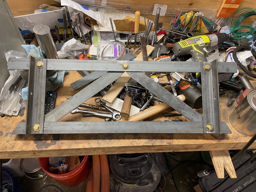

Mine is a 22 runabout. I made a bracket that bolts the center body mount and the bottom of the wood plank that supports the back of the seat bottom. It is braced to the rear so it resists forward momentum. It’s all bolted together so I can get it in piece by piece for a tight fit and it is braced in the middle so a centrally mounted belt can’t bend the center up. Here is a picture of the frame in progress on the bench. The sticking point is the best way to attach the belts to this bracket, through the board, and allow the seat bottom to go in and out.

If you attach the belts to the car frame, be absolutely certain that the body cannot detach from the frame in an accident. It would be a good idea to anchor the seat cushions to the body. A steering wheel with a pressed steel spider and composite rim is probably safer than a forged or cast spider and wooden rim. I don't know whether the composite rims have a steel core or not, but a steel cored rim with the steel core attached to the spokes would be safer than a rim that could easily break away from the spokes.

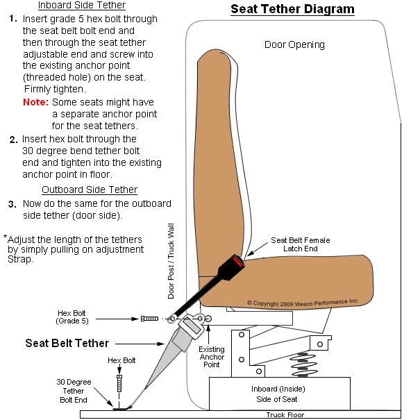

The argument for seat belts in a Model T is much the same as for wearing a helmet while driving a motorcycle. The recent Model T accident in West Plains MO may have ended up with the driver thrown from the vehicle
Here are a couple of links for mounting lap style seat belts
https://www.wescoperformance.com/lap-belts-install.html
https://www.wescoperformance.com/2-poin ... stall.html
https://www.seatbeltsplus.com/mm5/image ... 20Belt.pdf
https://www.retrobelt.com/pages/seat-belt-fitment
Child seat installation
https://www.healthychildren.org/English ... LATCH.aspx
Here is an interesting diagram for a semi-vehicle having a high seat. The seat belt is secured to the seat frame and a tether is used from the same anchor point to the floor. All pictures of seat belts anchoring positions show the same angle of the belt relative to the floor.
