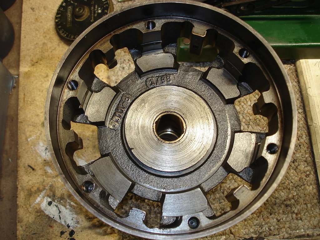

I picked this up in Hershey this year. It's not marked Ford anywhere. Just the part number and the date. I'm thinking J&M, but they usually have their name in the casting, don't they? Also, wondering why it was removed. It shows almost no wear or damage, I have not checked the balance yet.
Anyone know anything about who made it or its "reputation"?

As a point of reference, here is a photo of a NOS narrow brake drum. Note that it has both the name “Ford” in script and the factory number T-709 cast into the web of the drum. The one in your photo shows that it has the catalog number 3311 cast into the web. To my knowledge, Ford always used factory numbers in identifying parts at the factory, never catalog numbers.
Several people have made new drum castings over the years and attached them to used gears or shafts. Your drum appears to have a casting date (or a mold date) of January 1998. It may have been made by the late Bob Evans.

Thanks Trent. I knew it wasn't genuine Ford, but didn't know just who may have made it. To your knowledge, and with respect to the departed Bob Evans, do you know if in use, these hubs have/had a good reputation? Assuming that it was truly an Evans product of course.
Since posting my question, I put the drum between ball bearing lathe centers. Not a true test of balance, but still, no "heavy side" seems to be apparent.

Yes: We always have our name and batch and date in our drums. Only way to protect ourselves from brand X drums.Jerry VanOoteghem wrote: ↑Thu Dec 22, 2022 10:28 amI picked this up in Hershey this year. It's not marked Ford anywhere. Just the part number and the date. I'm thinking J&M, but they usually have their name in the casting, don't they? Also, wondering why it was removed. It shows almost no wear or damage, I have not checked the balance yet.
Thanks!
Most likely that is a drum made by Bob Evans using the Herman Harder Molds.
This drum you have shown is the reason we got into making the transmission drums as the quality isn't there nor the fit.
I remember what started it; I was trying to fit the replaceable clip for the brake drum lugs and they wouldn't stay on.
We had to purchase the prints from Ford and made all our drums exactly to the print including broaching the brake lugs which no one else offers.

I checked the OD runout of the drum, it's off .010 TIR with the shaft running with zero runout. There is less than .001 face runout. I can take a small cut off the OD to true it up. There's lots of stock left.J and M Machine wrote: ↑Thu Dec 22, 2022 4:10 pmYes: We always have our name and batch and date in our drums. Only way to protect ourselves from brand X drums.Jerry VanOoteghem wrote: ↑Thu Dec 22, 2022 10:28 amI picked this up in Hershey this year. It's not marked Ford anywhere. Just the part number and the date. I'm thinking J&M, but they usually have their name in the casting, don't they? Also, wondering why it was removed. It shows almost no wear or damage, I have not checked the balance yet.

Are you saying the drum lugs tend to be undersized on the Evans drums? Might explain why 3 are missing on my example!

"Are you saying the drum lugs tend to be undersized on the Evans drums? Might explain why 3 are missing on my example!"
An Affirmative Yes:
Most frustrating thing for us rebuilding engines is when the parts don't fit or fail.
As I mentioned these were the reason we started to make them the right way.
