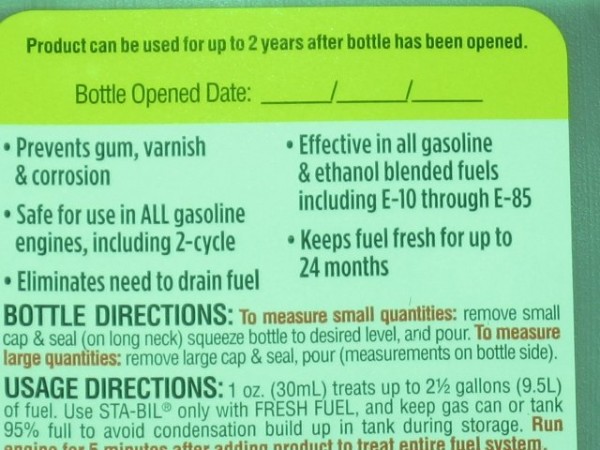

Pep C Strebeck
Posts: 646
Joined: Sun Jan 06, 2019 11:12 am
First Name: Joseph
Last Name: M
Location: MI
Re: Sta-Bil or Seafoam?
Post by Pep C Strebeck » Mon Apr 29, 2019 10:36 am
Peter, Memphis TN wrote:
Mon Apr 29, 2019 9:24 am
Both claim to stabilize gasoline in the tank, although neither says how long.
The label on the bottle says "UP TO 24 MONTHS". If I am going to store something for 2 years, I would definitely drain out the gas.
Depending on how long something is going to sit and how much fuel is in it, those are the deciding factors for me if I am going to drain the gas or let it sit. If I drain the gas I still add the Sta-Bil when there is just a small bit left and then run the engine/carburetor dry. I do not use Sta-Bil on anything 2 cycle, the 2 cycle oil that I use (Stihl) has fuel stabilizer already in it.
